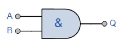

AND
This function utilizes an AND gate in digital circuits. An AND gate is a fundamental digital logic gate that generates a true output (1) only when all its inputs are true. This feature is essential in industrial controls, where machinery functioning may rely on multiple safety conditions being met simultaneously. Using AND gates guarantees that all specified conditions are fulfilled before receiving an input signal.
AND gate function
Figure 1. This image illustrates an "AND" logic symbol. "A" and "B" inputs must both be active to energize the "Q" output signal. Image used courtesy of Carlo Gavazzi

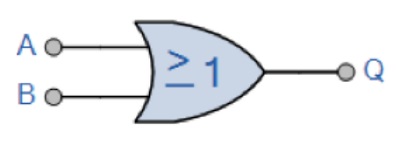

OR
The "OR" logic function is a fundamental operation in digital logic. Its output is true if at least one of the inputs is true. You can imagine it as a decision gate that opens if any of the specified input signals indicate a "true" state. For example, in a simple scenario with two inputs, A and B, the OR gate output will be true if either A or B (or both) is true. This function is commonly used in circuits to model scenarios where multiple conditions can lead to a single outcome, providing reliability in systems that respond to various input combinations.
OR Gate function
Figure 2. This image shows the "OR" logic function. If either "A" or "B" receives an active signal, "Q" will also give a signal. Image used courtesy of Carlo Gavazzi

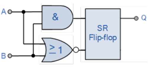

Gated SR-FF
A gated set-reset flip-flop can be compared to a room with two buttons on the wall: one to turn on the lights (the set button) and one to turn them off (the reset button). However, this room also has a unique switch by the door (the gating switch). When the gating switch is on, pressing the set or reset button immediately affects the lights. But if the gating switch is turned off, the set and reset buttons won't affect the lights until the gating switch is turned back on.
This arrangement allows for precise control over when the set and reset actions take effect, adding a layer of flexibility to managing the state of the lights. In digital circuits, this concept is used to control when certain operations occur, enabling precise timing and coordination of actions.
Gated flip-flip logic block
Figure 4. A digital circuit reference to the "gated SR-FF" function. Image used courtesy of Carlo Gavazzi
