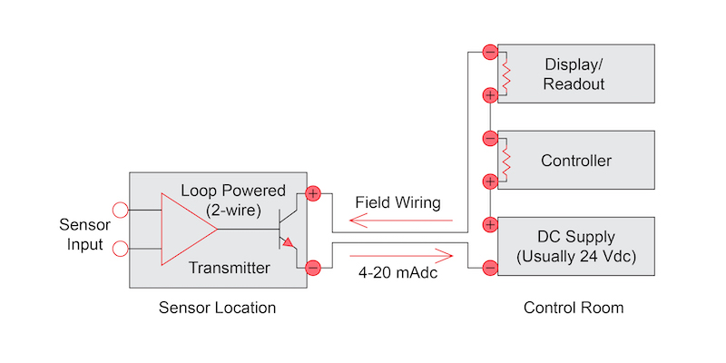

Loop-powered transmitters–also known as two-wire transmitters–receive DC power from a remote source. As shown in Figure 1, they transmit their output over the same wire pair by controlling the current from that source, eliminating the need for separate power wiring.
Figure 1. Loop-powered transmitters receive their power and transmit their output over the same pair of wires. Author's image.
The transmitter usually is located in the field, near the point of measurement, while the power comes from a DC source in the control room. Control or readout instruments are wired in series to read the current, forming a current loop. The supply voltage is usually, but not always, 24 VDC.

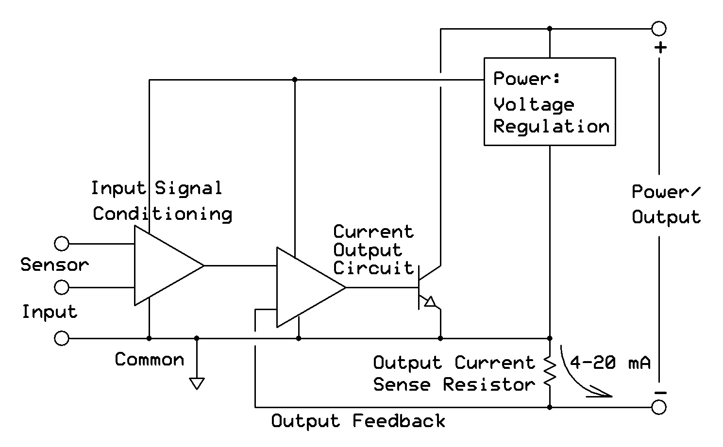

Figure 2 shows the internal operation of a typical loop-powered transmitter. Its power is “stolen” from the loop current by a voltage regulator circuit and used to power the rest of the circuitry. The total circuitry must be designed to run on less than 4 mA.
Figure 2. Block diagram of a typical loop-powered transmitter.
Signal conditioning circuitry, which varies depending on the input type, drives the current output circuit that, in turn, drives an output transistor. The total current, including the supply, flows through an output sense resistor that provides feedback to control the current. Feedback maintains the proper current despite changes in the transmitter’s power input voltage.

Input often must be galvanically isolated from the power and output. This means no electrical connection between the input and the 4-20 mA loop. There are two reasons for this isolation. First, if the output loop is grounded, the input cannot also be grounded. Look again at Figure 2. Circuit common is not the same as the output. If the input common and the negative output are both grounded, they will be connected, shorting out the current sense resistor and creating serious errors. This is a common problem with grounded thermocouple probes.

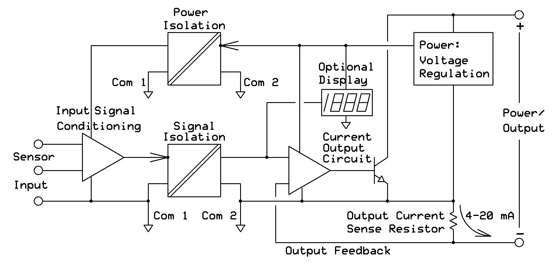

Fortunately, loop-powered transmitters are available with input/output isolation, as diagrammed in Figure 4. Operation is the same, but isolation is added to the power and signal paths. Power isolation is usually done using transformers. The DC voltage is chopped to make AC, then fed through a transformer and rectified back to DC on the output side.
Figure 4. Block diagram of a loop-powered transmitter with input/output isolation and optional display.
Signals may be isolated in several ways. On older designs, transformer isolation was used, but optocoupler and capacitive isolation are the typical solutions for modern equipment. The conditioned input signal is converted to pulse or frequency modulation, fed through the optocoupler or small high-voltage capacitors, and converted back to DC. Modern transmitters often use microprocessors or microcontrollers instead of all-analog circuitry, making coupled pulses the obvious choice.
