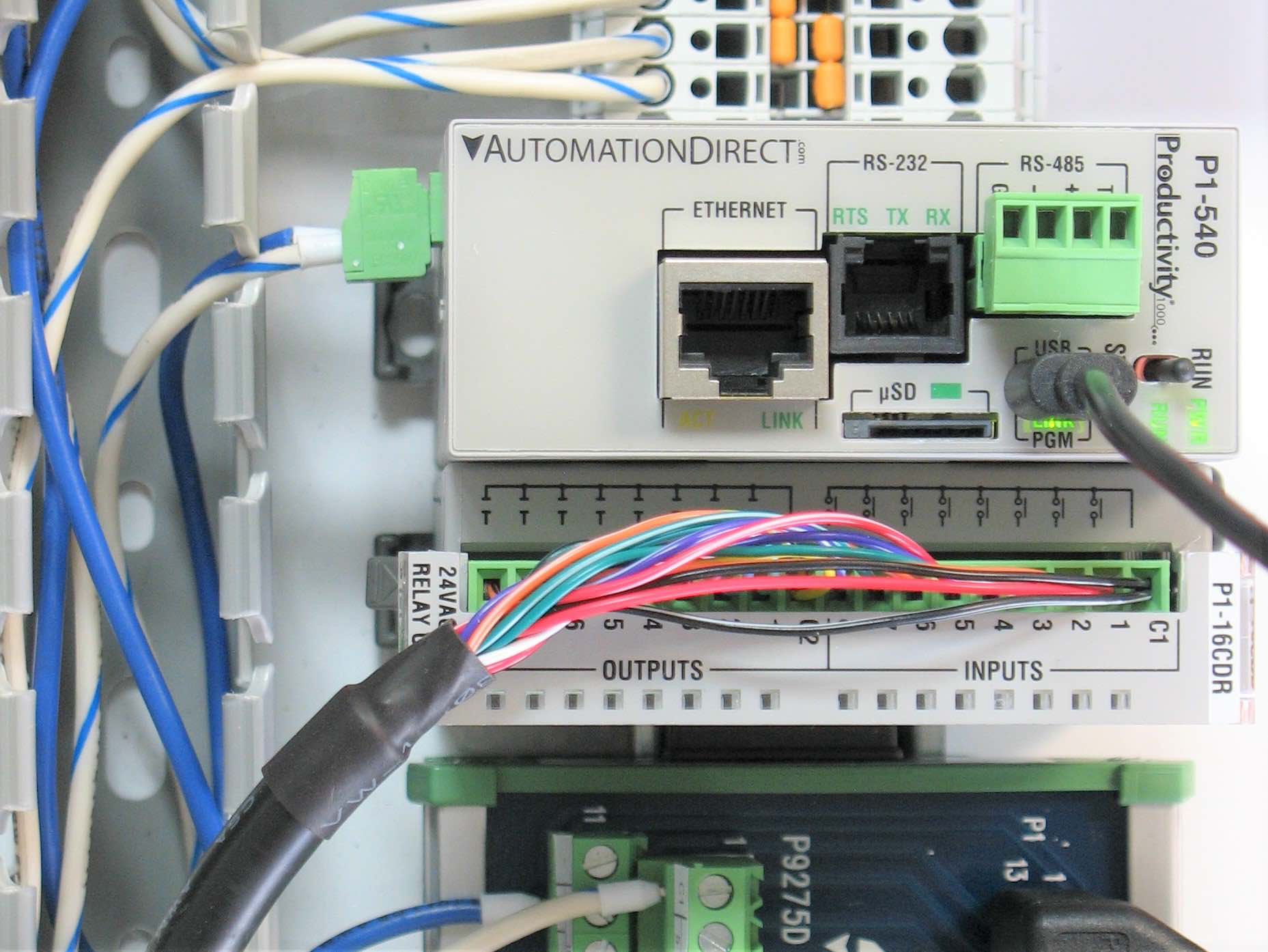

Some of the more common terms to clarify include RS-232 and RS-485, Modbus, Profibus, and the more modern USB and Ethernet. Many other systems exist, but many of these are proprietary systems that are offshoots of one of those common ones.
PLC showing communication protocols
Automation Direct PLC showing four common communication interfaces for programming and networking - USB, RS-485, RS-232 and Ethernet.

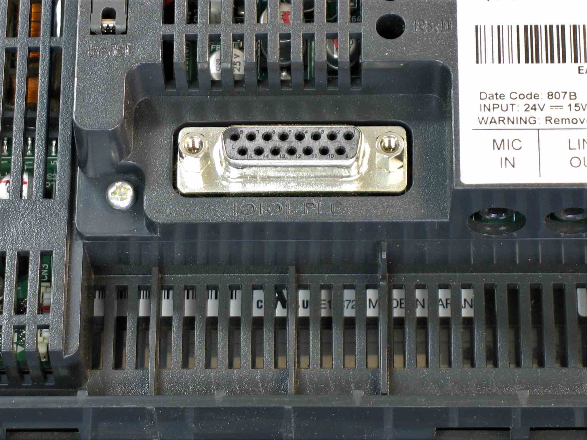

The smallest digital networks that can be formed are Point-to-Point. They consist of only two devices linked with a single cable. USB is the most common type of P2P connection in the modern world, but another common standard, RS-232, is still used to interface with a variety of digital controllers like PLCs, HMIs, and VFDs. It is recognized by the 9-pin ‘serial’ connector or an RJ connector just like an Ethernet jack, except only 6 pins instead of 8.
RS-232 is a relatively slow standard, making it most suited for communication with microprocessor driven devices. These controllers almost always have speeds vastly slower than modern computers, so there is no need to constantly change them just to keep up with the latest laptop connector. However, as technology progresses, we are certainly not surprised to see modern connections on brand new devices. What current PLC doesn’t have either an Ethernet or USB connection or both?
HMI connector labeled with protocols
HMI Connector labeled as IOIOI-PLC which in this case allows RS-232, RS-422 and RS-485 connections from the same 15-pin interface.
Although USB and RS-232 standards define the voltage levels, the pin functions of the connectors, and the speeds (baud rates), the protocol, or format of the communication used on these channels can vary drastically. Device driver software is critical to ensure that both the host and client devices communicate properly.

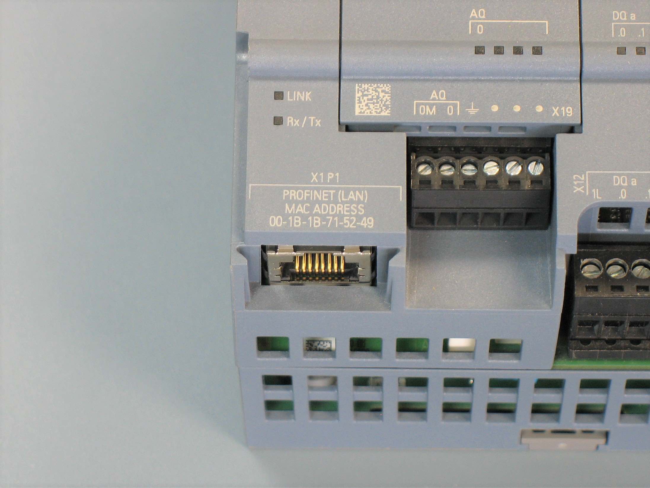

Ethernet is the widest-reaching of the multipoint networks simply because of its ability to interconnect separate subnetworks across a facility or around the world with internet access. Since this communication network is so complex, the standards and protocols are defined in the IEEE 802 publication. Be careful of the connectors. Although Ethernet has the familiar 8-pin RJ45 jack, other connections such as RS-232 used for programming can have deceptively similar connectors.
When one of the common protocols such as Modbus or Profibus must interact with an Ethernet system, it’s common to have an adapter, such as a Modbus TCP/IP converter or gateway. Sometimes, the conversion to Ethernet may be built-in such as in the case of Profinet, which changes the Profibus protocol into Internet Protocol to communicate with a wider network of devices.
siemens controller
A Siemens S7 Controller with a PROFINET connector which allows the Profibus to communicate over an Ethernet network.
