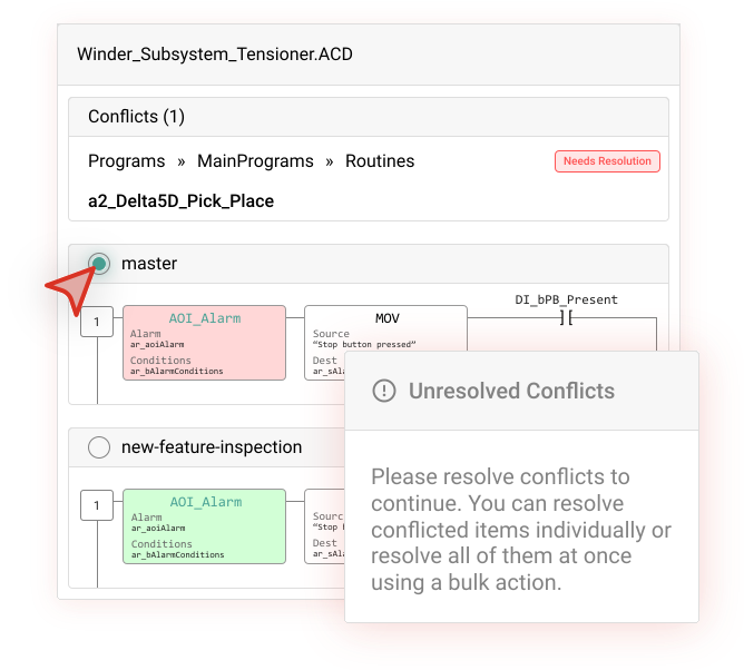

PLC programming with multiple developers possible with merging branches on Git
Figure 1. The ability to merge branches of code from different developers is a useful feature of Git that prevents disrupting the main branch or other developer’s work. Image used courtesy of Copia Automation

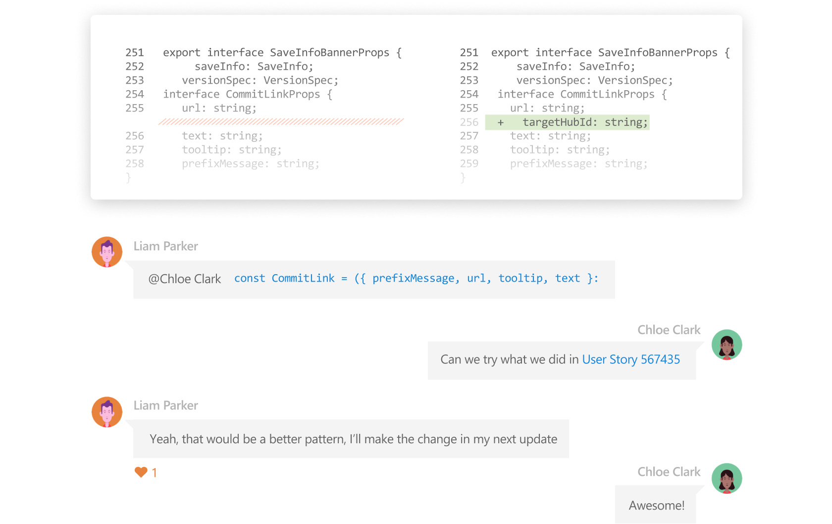

Microsoft' Azure Dev Ops Services utilizes the Git workflow with their cloud remote repositories
Figure 2. Microsoft’s Azure Dev Op Services utilizes the Git workflow with their cloud remote repositories. Image used courtesy of Azure Dev Op Services

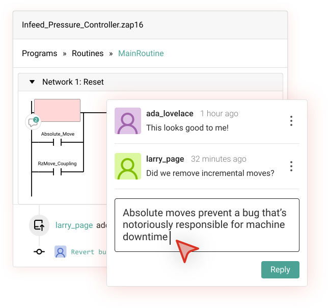

Copia Automation Git software so multiple developers can make comments to rung changes
Figure 3. Using Copia’s software, users can make comments directly to rung changes and work with multiple developers on the same project. Image used courtesy of Copia Automation
Copia Automation is an industry leader in using this online repository, specializing in using Git for industrial automation software. They support many different makes of PLCs and make use of the Git workflow, meaning you can view the source code with the online or desktop app, comments can be made directly to rung changes, and multiple developers can work on the same project by making use of the multiple branches and merge features. This workflow is different from what most PLC programmers and maintenance staff are used to, but the benefits can pay off when you need to access backup programs remotely or if you develop code with a team.

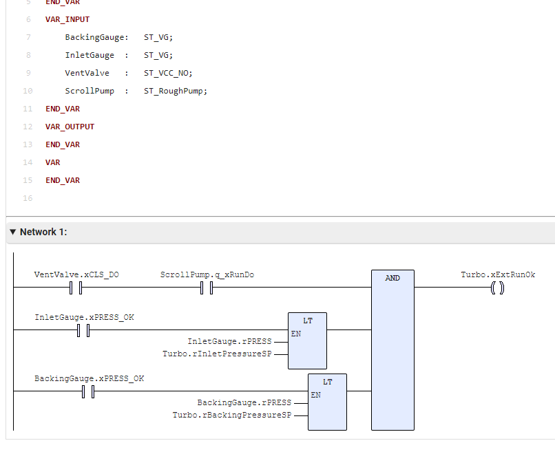

Copia's rendered ladder logic of a Beckhoff TwinCAT3 TcPOU file
Figure 4. Copia’s rendered ladder logic of a Beckhoff TwinCAT3 TcPOU file. Image used courtesy of Copia Automation

During the development process, multiple programmers need to work on the same file at the same time and manually merging code from multiple programmers can be a tedious full-time job. With the use of Git and Copia’s remote repositories, PLC programmers can protect their work and work simultaneously with other programmers. With Copia’s ability to render ladder logic, function block diagrams, and structured text, senior programmers will be able to perform code reviews without having to open multiple programming environments.
