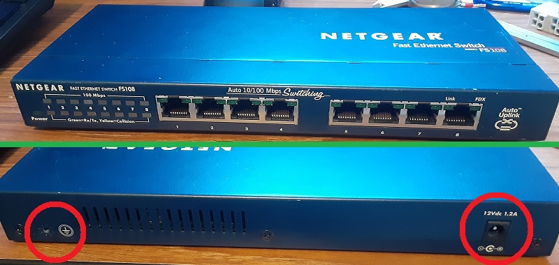

Functionally speaking, yes, you can use a general-purpose network switch to supply your needs, since most low-cost commercial and home-use internet switches can easily pass the bandwidth and data rate required for industrial equipment. I’ve used many switches that were laying in a used equipment box in my office and connected my benchtop network without a single problem.
Front and back of a network switch
Figure 2. The front (top) and back (lower) view of a general non-industrial Ethernet switch. The power rating and the grounding screw terminal can be seen in the lower half of the picture.

Most residential-grade switches use a power adapter from a standard 120 volt outlet to provide a DC output of around 12 volts. This is simply because most homes and offices don’t have power networks providing that DC voltage.

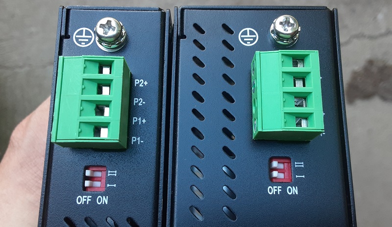

Not only is the power input rated at 24 volts DC for these industrial-grade switches, they often have power inputs labeled 1+/1- and 2+/2- or similar, just in case one supply is overloaded and shuts off, the network will still remain solidly functioning. While a power supply may knock a couple of components offline (obviously not good in itself), a network fault can cause disruption to an entire facility.
Dual power inputs
Figure 3. Not all industrial switches have dual power inputs, but power reliability may be a key factor in the decision to ‘go industrial’.

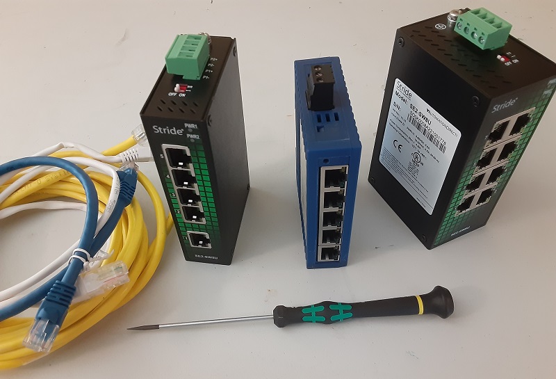

Most industrial switches use a DIN rail mount clip, allowing you to place them in the best location to avoid interference of both signals and physical obstacles.
Regarding the form factor, power connections are usually on the top or bottom, with the connection ports and any other reset, etc. buttons placed on the front, facing the technician when the cabinet is opened. Home-grade switches often have those reset buttons on the backside, along with the power connector.
Imagine needing to remove the component from the rail, and disconnecting all of the neatly arranged cables just to access critical buttons.

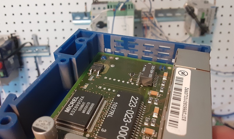

Ingress protection is not a big deal in a clean office. But turn to a setting involving sawdust or metal particles, and even a small opening can be an open invitation for failure. Not only openings, but many standard switches use a fan for cooling, drawing air in across the PCB components to keep operation more efficient.
Some industrial switches are not entirely sealed, meaning you can’t be careless about placement, but they are designed specifically to withstand harsher environments that would destroy a typical network switch.
Dust inside a PCB enclosure
Figure 4. Dust ingress, while not always entirely preventable without an IP67 rating, can be minimized with proper installation (this is an IP30 switch).
Some are indeed rated as IP67 with fully sealed cases and ports, often using specialized cable terminators. This rating will certainly add to the cost, but it allows the switch to be installed in hostile environments. Most of these devices are not the DIN-rail mount, but rather are designed for installation directly on a machine. They usually have a longer, thinner profile with screw mounting holes at the top and bottom.
