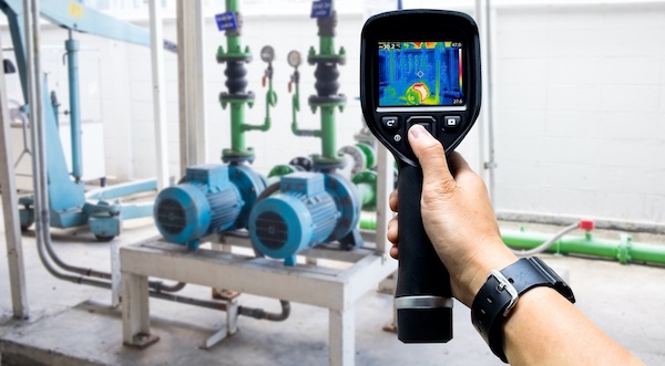

An effective low-cost measurement tool for thermal analysis is a non-contact infrared (IR) thermometer. They are often called ‘point-and-shoot’ since they use a trigger and often a red laser indicator as well. The level of accuracy depends on the consistency of the measurement, including the ambient air conditions and the distance between the thermometer and the test component. They can often be trusted to within a few degrees, so they can point to large changes, but not if the temperatures only change by fractions of degrees. These thermometers are excellent for quick general data recordings of many points.

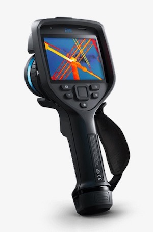

Thermal imaging cameras (TICs) can provide an image of a scene, much like a standard camera, but instead they point out hot points and components. It can be used in the same way that the smaller non-contact models are used, except they provide far more specific information. Rather than simply indicating that a metal bearing housing is getting a little warmer than normal, you may be able to see that the top-left side of the bearing housing (for example) is the origin of the heat from friction.
Figure 2. The FLIR E96 14 hand-held infrared camera. Image courtesy of FLIR

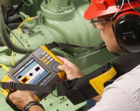

Commercially available mobile vibration sensors can be pressed up against rigid, fixed components to measure vibration in three axes. Again, the actual amount of vibration or motion is not as useful as knowing the deviation from a properly working tool.
A technician uses the Fluke 810 Vibration Tester.
Figure 3. A technician uses the Fluke 810 Vibration Tester. Image courtesy of Fluke.

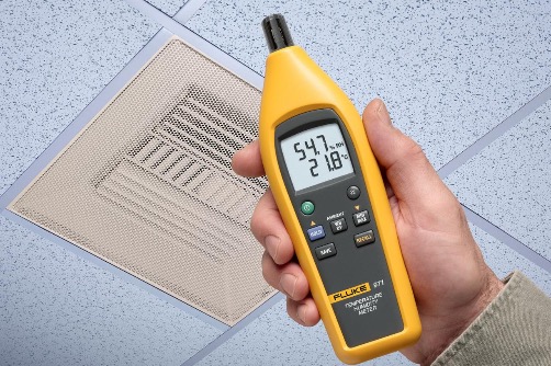

This final measurement requires specific humidity sensors to properly collect data. They usually are not very expensive or difficult to install. Humidity is different than the previous two measurements since there usually is a stated acceptable humidity range for any device. If the reading falls outside of this boundary (usually the problem is when humidity is too high), an external contact can enable a heater or air dryer to reach the proper conditions.
fluke 971 temperature and humidity sensor
Figure 4. The Fluke 971 temperature humidity meter tracks temperature and humidity in the air. Image courtesy of Fluke.
