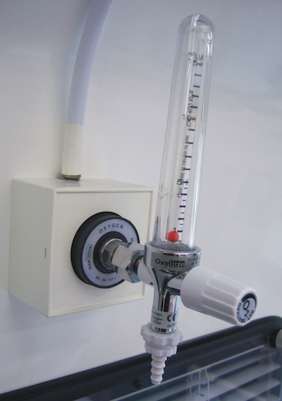

Rotameter
This type of gauge consists of a gradually increasing diameter of a pipe, usually transparent a vertically mounted, with an indicator floating inside.
Figure 1. A rotameter used in a medical oxygen regulator. Image by Owain Davies [CC BY-SA 3.0].
As the fluid moves faster, a greater area is required to transport the fluid, so the indicator floats higher. The flow rate is marked on the side of the meter, with a greater height corresponding to a greater rate of flow.

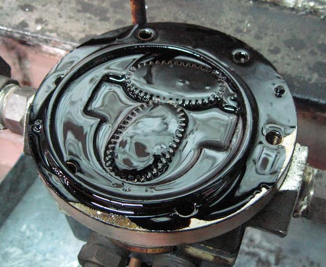

Displacement Meters
These gauges allow a fixed volume of fluid to be transmitted through the system in fixed intervals. This could be thought of similarly to a waterwheel where each little bucket holds a fixed volume. Faster rotation means more buckets in a given time, and flow can be easily measured. Many styles of gears, vanes, and pistons use this measurement concept, as long a fixed volume exists between each tooth or vane or piston cycle.
Figure 2. A positive displacement flowmeter with oval gears.
