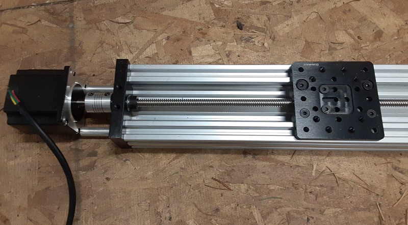

Figure 1. An electric actuator in the form of a linear lead-screw rail. Other variations include belt and chain drives.

Electric actuators are efficient and can be tightly controlled. This means more precise motions are possible with electric actuators than with other systems. For example, an automated end mill can more precisely move the axes during machining than a fluid-based system. This is partially because there is no way for the electrical energy to “leak” like it might in a fluid-based system.
Computer control is much easier to perform with electric actuators than with other actuation systems. This is because the control signal is already a voltage or current, versus having to convert a voltage or current signal into another physical phenomenon, such as compressed air pressure in a pneumatic system. The fewer steps, the more quickly this can happen. Also, the computer control system can more readily accept data from sensors and from the actuator itself and develop more accurate positioning control signals. Advanced actuator routines can be developed quickly, such as pulse-width modulation (PWM), where a signal’s duty cycle can be altered to slowly increase the motion of a robotic arm, creating more complex motion profiles.
The only caution to consider with electrical controls is the existence of electro-magnetic interference and resistance in the wiring. Both of these problems can easily introduce errors in the final output command, and therefore, the final position of the actuator.

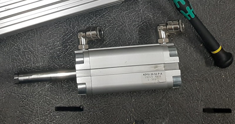

Figure 2. Pneumatic actuator (commonly called a ‘cylinder’).
Pneumatic Cylinders
Pneumatic actuators are powered by compressed air. Many factories have compressed air lines that run through the factory, so pneumatic actuators are extremely common in motion control systems.

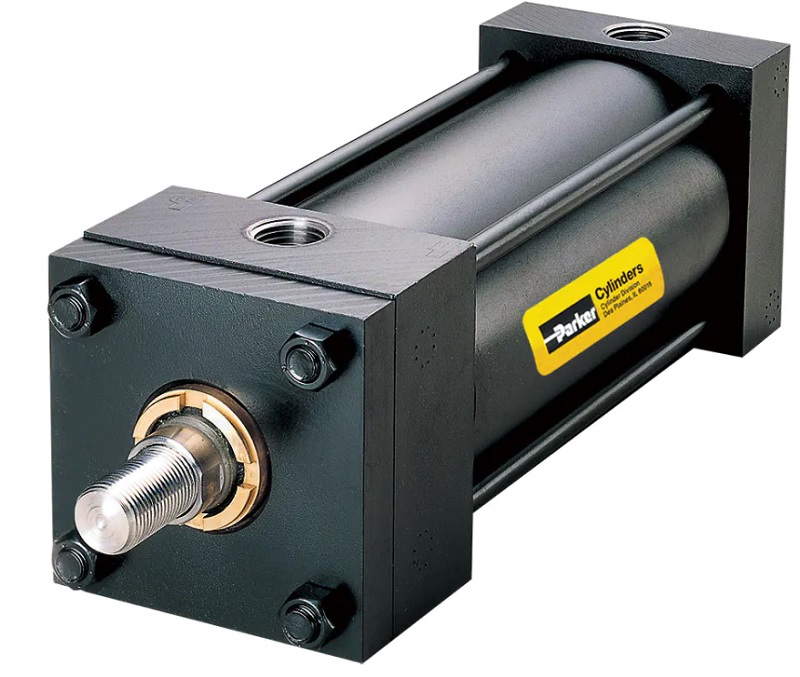

Figure 3. Hydraulic actuator (also called ‘cylinder’). Image used courtesy of Parker
Hydraulic Cylinders and Motors
Hydraulic actuators are moved by forcing a liquid, usually a heavy oil or specialized hydraulic fluid, into the system. Unlike pneumatic and steam actuators, the hydraulic fluid is virtually incompressible. Very little energy is lost compressing the fluid, but instead, is used for motion of the actuating component.

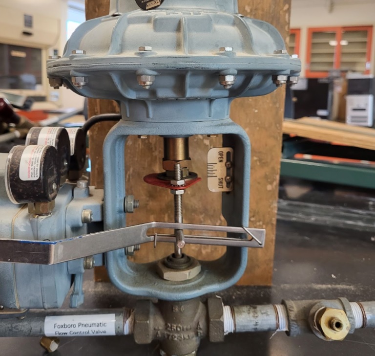

Figure 4. This pneumatically-actuated control valve can be used to alter the flow of cooling water through the system. The air control can use a mechanical level control, or an electronic pressure sensor, as its control variable. Author’s image
