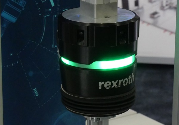

Force compliance device
Figure 1. Force compliance devices find use in tasks that are subject to frequent misalignments and inconsistencies.
It is important to note that misalignments are not just a result of inconsistencies in designed processes, but can stem from uncontrolled variables as well. Consider a robot that is performing a picking operation of randomly-oriented components from a bin. Those components may shift right as the robot accelerates and begins moving to the pick point, leading to misalignments from a machine vision system’s image to the reality of picking up the product. Thermal expansion of components may lead to misalignment as well, which means machine dimensions during startup may be different than the dimensions during regular use.

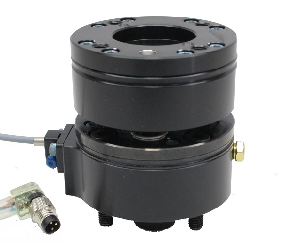

Spring loaded force compliance
Figure 2. Mechanical force compliance with springs providing force. This model also has a pneumatic cylinder to return the plate to the center position. Image used courtesy of ATI Industrial Automation
More complicated mechanical compliance devices involve spring-loaded systems that can trigger additional force to bump a robotic gripper a little closer to where it needs to be. Others have flexible spring surfaces that apply more or less force depending on the position of the part along its surface.
The key feature with mechanical compliance devices is that they must be able to reset to their original shape. Springs, tension bars, soft robotics, and so on must only deform in the elastic region, else they will need to be replaced. Furthermore, the contacts between these surfaces must remain clean, as a speck of dust will change the delivered force to the component.

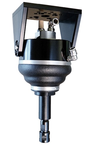

Pneumatic deburring compliance tool
Figure 3. A pneumatic force compliance tool specifically designed for deburring. Image used courtesy of RAD Robotic & Automation Solutions
Hydraulic compliance devices also exist and serve the same purpose and behave in a similar manner to pneumatic ones. The choice between pneumatic and hydraulic can be determined by the specific needs of the facility. Often, there is compressed air available, making pneumatic devices common, though hydraulic systems can typically apply larger pressure. Furthermore, tapping into the in-house compressed air may not be desirable, as small robotic components will require cleaner air than many other pneumatic tools.
