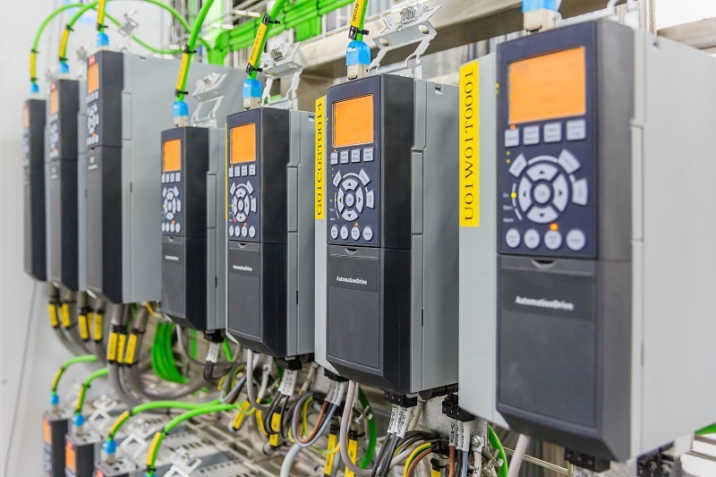

Figure 2. Motors and other inductive devices throughout the industry can tamper with data integrity. Image used courtesy of Adobe Stock
