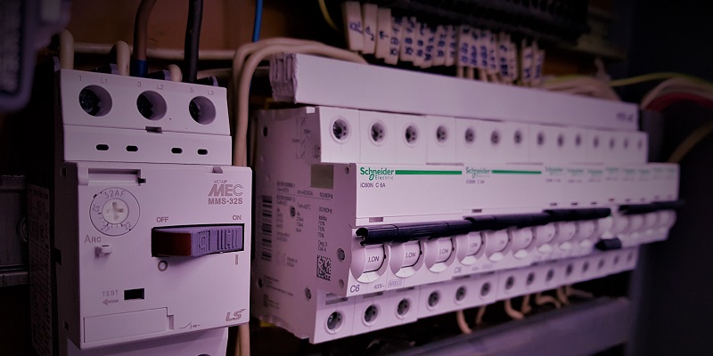

Cabinet wiring
Figure 1. Labeling the wires in a control cabinet is necessary for proper system maintenance. Photo by George Slabov on Unsplash
When a system is used for a period of time, there will inevitably be a loose connection or misplaced wire that needs to be found and addressed. Wire labels are used to match the wiring diagram to the wires in the actual system. Each label corresponds to a labeled line or connection point in the electrical drawing. Pneumatic and hydraulic hoses on a system often follow a similar pattern with their own corresponding diagrams and labels. This allows for simplified troubleshooting and easier modifications down the road.
Sometimes when troubleshooting, it is unknown whether the wire was landed incorrectly or the final destination device is the cause of the problem. A wire label will help to dispel the unknown factor by creating useful points for testing signals - even far away from the final device. Labels are useful for working safely in a cabinet. When the power is de-energized to the cabinet, it is important to check that power has actually been turned off. Without labels, it would take some time, and add layers of danger, to decipher where power should and shouldn’t be.

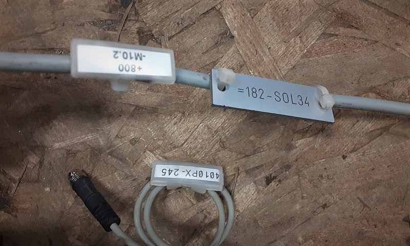

Tags are another method of labeling wires or tubes and have their own set of benefits and drawbacks. Tags can be used on any size wire but are normally reserved for larger wires and tubing. Some tags for smaller wires consist of two holes that the wire slides through. These tags can be applied only with the wire unterminated. They are durable and easily changed but have the drawback of sliding around on the wire.
Cable label options
Figure 2. Assorted tag options for labeling solenoid and sensor cables, as well as tubes and hoses.
Tags for larger wire bundles and tubes are often printed and have a hole or slot for a cable tie to slide through. The cable tie slides through the slot and then is tightened down to keep the tag in place. These types of connections are durable and can be installed with the wire terminated and connected.

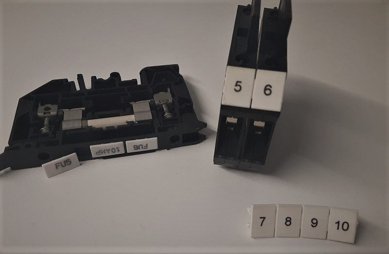

Pre-Printed Label Plates
Different manufacturers offer different solutions for creating a legible system for labeling terminals. One of the main ways of doing this is to print the label on plastic plates that can then be snapped into place on the terminal block, or purchase sheets of pre-printed labels. This method is very neat and precise but requires special plastic plates and a printer to print them on. These plates are not universal, and every model of terminal block will require labels that fit that specific part number. Labels can similarly be used for different components such as circuit breakers, relays, and switches.
Terminal Block Labels
Figure 3. A small variety of terminal block labels - these are pre-printed, but some can be custom labeled. Each model of terminal block requires appropriately-sized labels.
