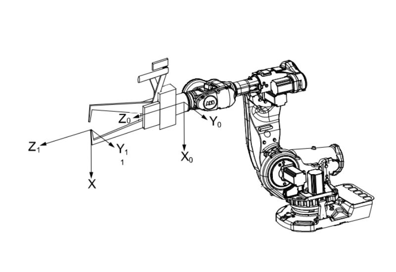

Default TCP location on a robot is at the end of the arm
Figure 1. The default TCP is flush with the mounting plate of the robot gripper. Image courtesy of ABB

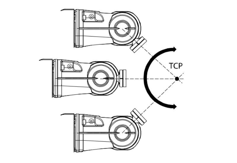

Calibrate TCP with multiple approach paths
Figure 2. Multiple approach paths to the TCP will allow the software to calculate the exact point by triangulation. Image courtesy of ABB

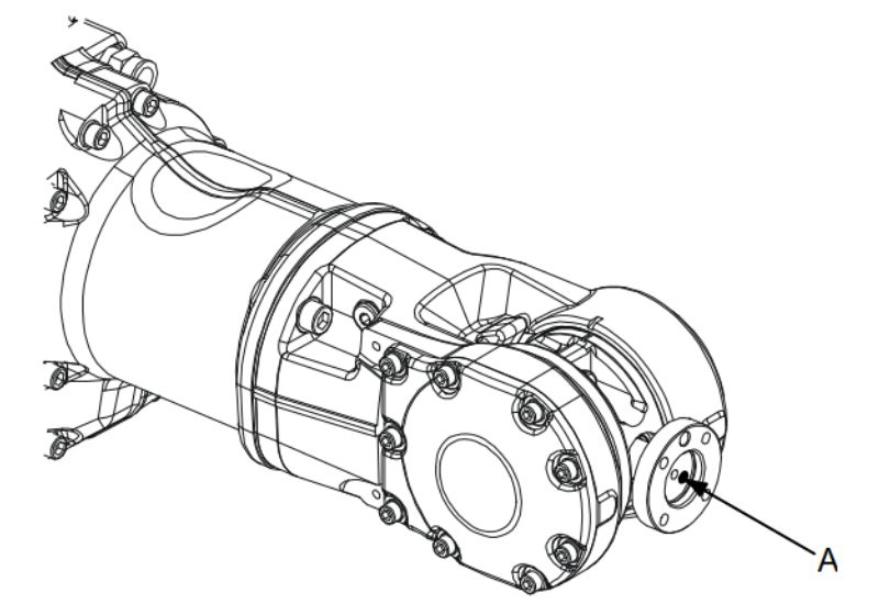

4-Point teaching method for TCP calibration
Figure 3. Using four points to identify not only the TCP location, but also rotational orientation. Image used courtesy of ABB

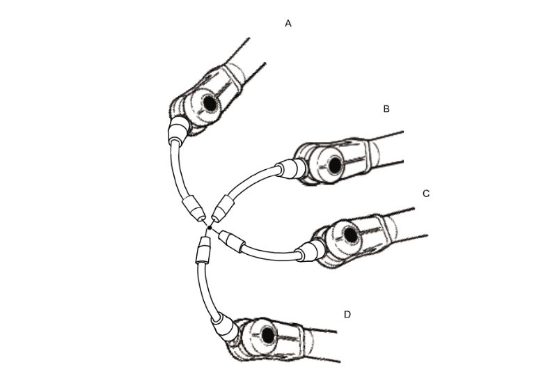

Spot welding TCP orientation
Figure 4. Comparing an original (0) and a new (1) TCP, in this case with only location change—the orientation has remained the same. Image used courtesy of ABB

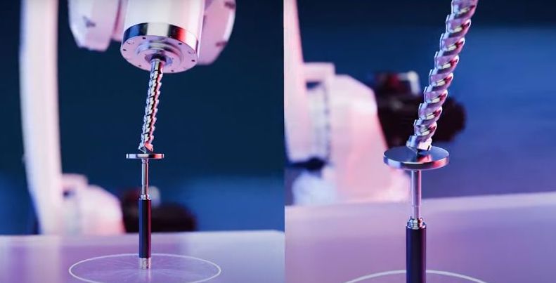

RoboDK's Twin Tool is an automated TCP
Figure 5. RoboDK’s Twin Tool is an easily-integratable, automated TCP that uses a linear sensor gauge to guide the robot into different positions. Image courtesy of RoboDK
Automated Method of Calibration for TCP
Today, there are some manufacturers that have come up with an automated or semi-automated method. RoboDK’s Twin Tool uses a linear sensor gauge to detect the robot’s tool in different positions. The software will guide the robot into multiple positions taking the human error out of the equation. Leoni is another manufacturer that offers a calibration aid system. The advintec TCP calibration system makes use of horseshoe-style through-beam sensors to detect the location of the tool.
