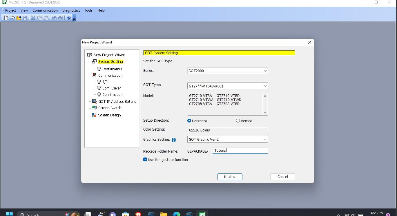

Once you have GT Designer 3 installed, you can launch the application to create a new project. A pop-up window with the title 'Start New Project Wizard' appears in which a new project can be set up. The wizard allows for setting up parameters like the type of GOT system, controller, GOT IP address, screen switching device, and screen design.
In the new project wizard, we can set our HMI series to GOT 2000, the set-up direction to horizontal, and name our package folder 'tutorial'. For the controller type to be connected to GOT, a selection can be made from a wide range of popular PLC brands like Siemens, Omron, and Mitsubishi Electric, among many others. For this tutorial, we are going to use a Mitsubishi Electric PLC (MELSEC FX series) and the GOT 2000 series HMI.
Wizard for creating a new HMI project
Figure 1. New project setup wizard.

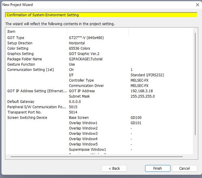

Once the GOT and the controller type are set, you can click 'next' to choose the connection interface (I/F) from a drop-down list of a range of communication protocols for data transfer between the GOT HMI and the PLC. For our case, we are using the RS-232, one of the standard I/F for the MELSEC-FX series. Once this is done, we can choose the screen design and finally confirm the system environment setting by selecting ‘finish’.
Parameters for new HMI project
Figure 2. Project parameters.

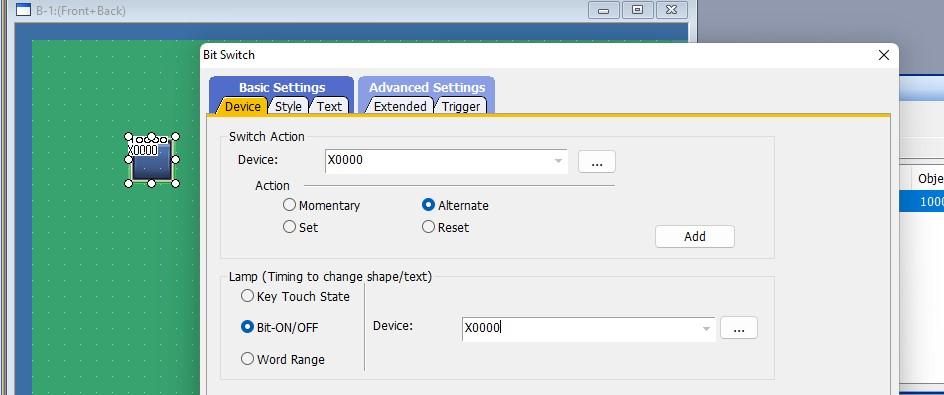

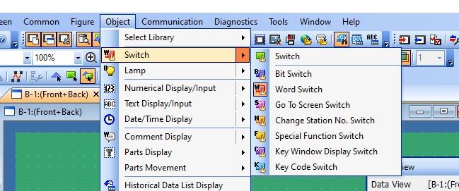

With the new project setup complete, we can then create an interactive button to control the status of a bit lamp. Under the object tab, select 'bit switch' and place it in any position on the base screen. A switch is much like an illuminated pushbutton that will send a high or low signal to a corresponding bit in the PLC, and can also be lit like a lamp from a bit in the PLC.
Adding a bit switch to the project
Figure 3. Adding a bit switch into the HMI project.
Under the same tab, a bit lamp can also be added on the base screen. The lamp is only an indicator light, responding only to the status of a bit from the PLC.
Once the two objects are added to the design window, addresses can be added for identity and must correlate with the ones connected to the PLC I/O. In our case, our HMI design will have the bit switch with the address X000 for ON/OFF functionality.
Setting the bit switch address
Figure 4. Setting the address for the bit switch in the HMI project.

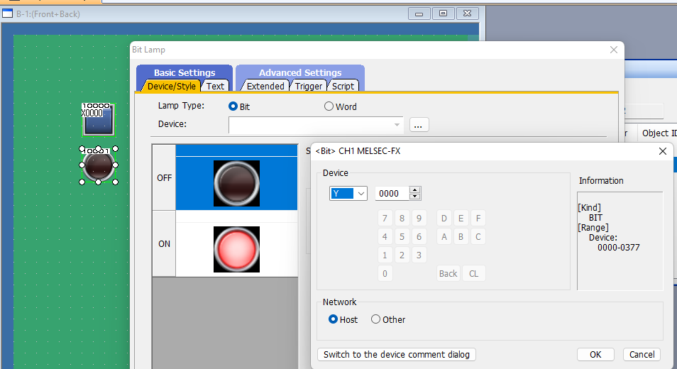

For our bit lamp output, we can add the address Y000 by double-clicking on it to open a setup window like the one shown below. The lamp type is Bit, and the address is added in the textbox just beside the word 'Device.’
Setting and addressing the bit lamp
Figure 5. Adding a bit lamp and setting the address in the HMI project.

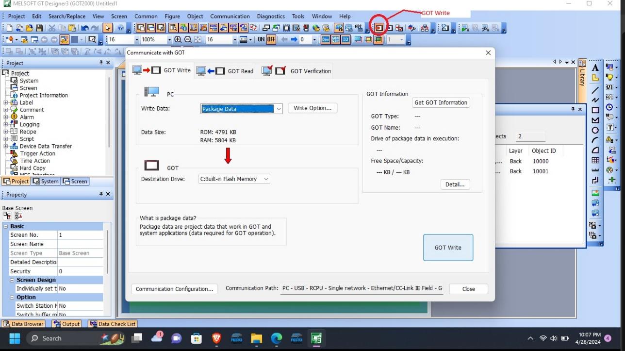

Once the addresses are added, the design is now ready to be written to the HMI. To do this, click on the communication tab which you can then click 'write to GOT' to write the design to the HMI panel. Alternatively, the icon circled in red in the image below can also be clicked to upload the design to the HMI. With the design uploaded, a ladder logic program is written and uploaded to the PLC where the lamp is connected to Y000 on the PLC output so that it can turn ON when X000 is clicked on the HMI panel.
Loading the project to the HMI panel
Figure 6. Writing the GOT project to the HMI.

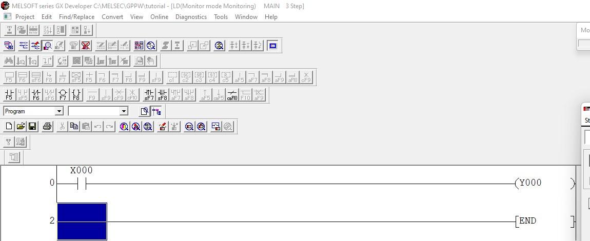

Following the design example we created earlier, we can simulate the ON and OFF status of the bit lamp using GT Simulator 3 and a PLC program written in GX Developer. To do this, launch GX Developer and create a new project, setting the PLC series as FX series and naming the project ‘tutorial’. Write the ladder logic program shown below taking note of the I/O addressing. Finally, click on the simulator icon to launch the GX Simulator.
To learn more on how to use GX Developer, check out our previous introduction article getting started with GX Developer and GX Simulator.
Simple PLC ladder logic program
Figure 7. The PLC project to match the simple on/off bit test on the HMI.

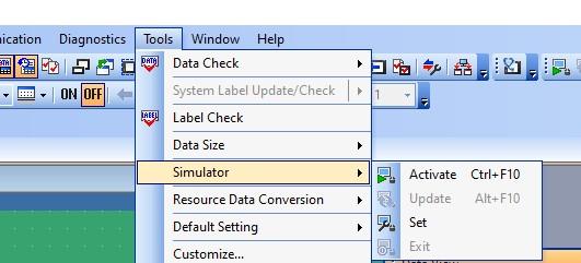

With the ladder written and GX Simulator activated, we can now launch GT Simulator 3 by going to the tools tab then 'activate simulator,' or simply use the keyboard shortcut ctrl+F10.
HMI simulator
Figure 8. Activating the HMI simulator.

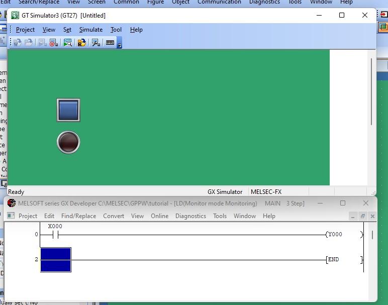

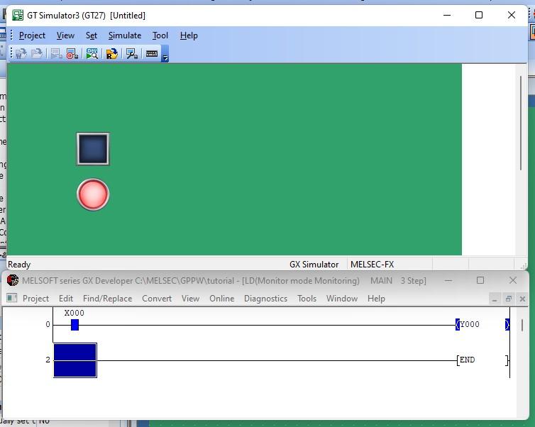

Once activated, the GT Simulator window opens showing the bit switch and the bit lamp and when the switch is clicked the lamp changes to a brighter color to simulate ON status. The object simulation of the HMI also directly affects the status of the ladder logic written in GX Developer as shown below.
Simulating the lamp when the bit is ON
Figure 9. Overlay of lamp and ladder logic when the bit is energized.
Simulating the lamp when the bit is OFF
Figure 10. Overlay of lamp and ladder logic when the bit is de-energized.
