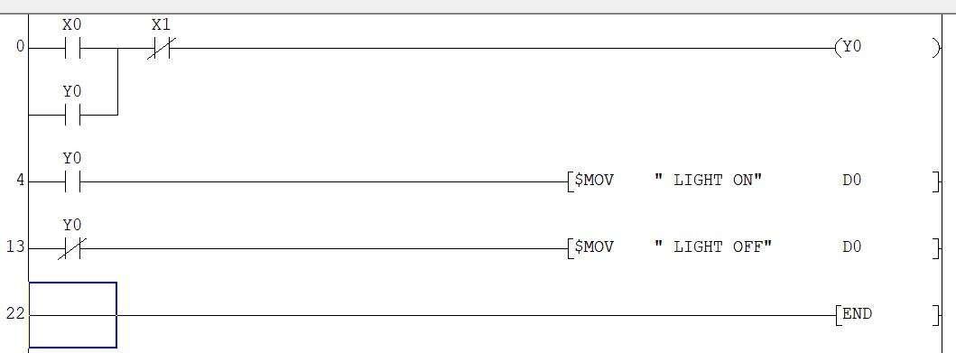

In this sample project, two momentary switches with addresses of X000 and X001 will be used to switch output Y000 (lamp) ON and OFF respectively. When the switch with address X000 is pressed, the text "LIGHT IS ON" is moved to data register 0 (D0) for the real-time status display of the lamp. However, when X001 is pressed, a new text "LIGHT OFF" is moved to D0, thereby changing the text displayed on the HMI.
MELSEC ladder logic for strings
Figure 1. Using MOV commands to populate a character string.
When writing a function to move strings to a data register, a MOV application instruction is selected, or use the keyboard shortcut F8 and carefully note the syntax of the character string transfer command:
--[$MOV Character String (S) Data Register (D)]--
S represents the text to be moved, and D is the address of the data register to where the text is being moved.

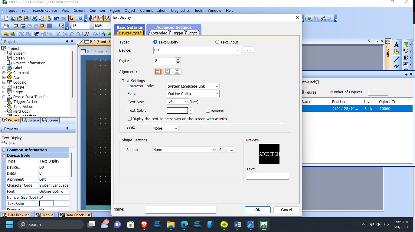

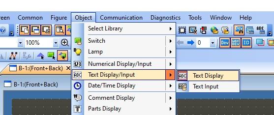

For the text display, add a text display box, also found under the object tab, and set the address to D0. The number of characters to be displayed can also be increased.
Properties for a Mitsubishi HMI text object
Figure 3. Configuring the text display object with the device address and character count.

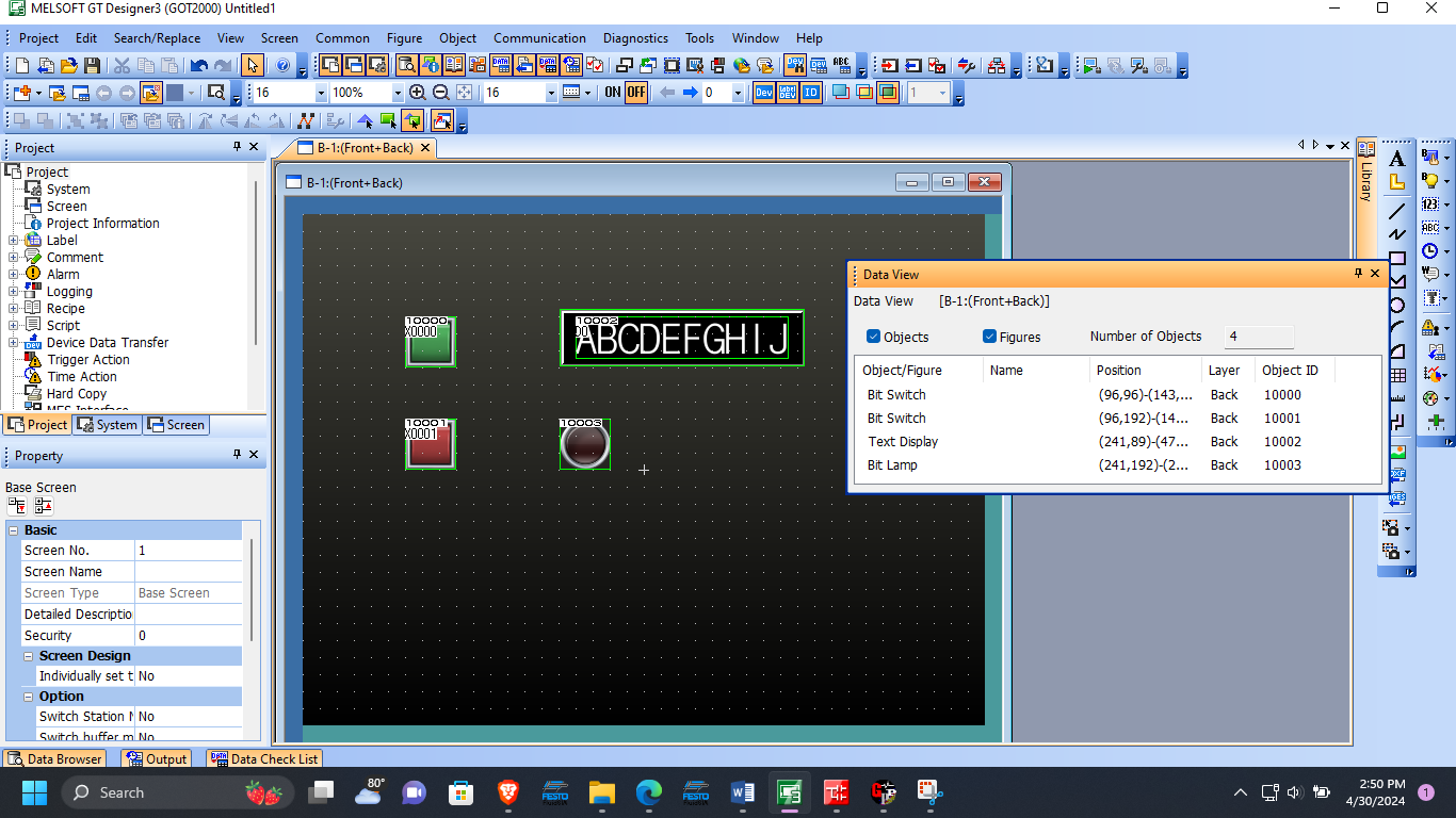

To better differentiate the switches, add the style color green for X000 and red for X001 for ON and OFF functionalities. The final design is represented in the image below.
Sample HMI screen display
Figure 4. Final HMI Design and a data view table indicating all the objects placed on the base screen.

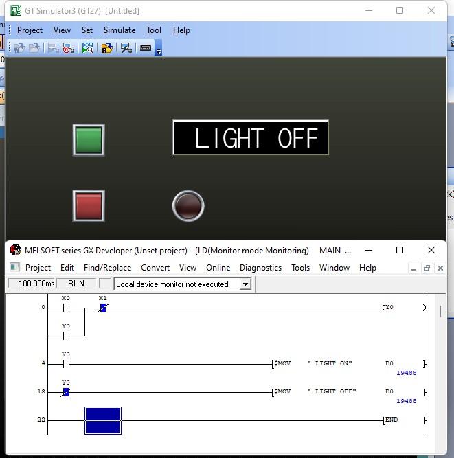

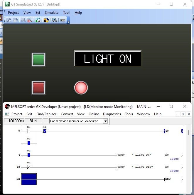

With the screen design complete, the program can be tested using GX Simulator and GT Simulator 3. This is done by launching both simulators and clicking on the switches to see the resultant outputs relating to the earlier written PLC program.
Indicator text and LAMP OFF
Figure 5. The string “LIGHT OFF” is moved to D0 when the red button is clicked or when the lamp is OFF.
Indicator text and LAMP ON
Figure 6. The string “LIGHT ON” is moved to D0 when the green button is clicked or when the lamp is ON.
