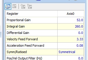

2. More commonly, the method of choice is to use the software already built into an existing pre-installed PID controller. The controller is supplied with a proportional gain in order to get a      fairly accurate response. Then, the system is driven one or more times to record and observe that accurate response.
While the system is driving, a profile of the output signal is recorded. It may need to overcome some friction in certain parts of the cycle, or maybe some other unusual circumstance occurred, but the controller compensated with an appropriate output profile.
Feedforward values for both Velocity and Acceleration in motion systems are often included in a PID setup software
Figure 3. Feedforward values for both velocity and acceleration in motion systems are often included in a PID setup software, like this one from Delta Computers RMC software.
In future cycles, that output profile can simply be played back. Theoretically, we could disconnect all sensors and expect the system to still overcome those friction load points correctly.

    In the case of the RMC controllers the feed forwards gains are determined by the inverse of the open loop transfer function.  The motion trajectory and the feed forward outputs must be computed on-the-fly because often commands are issued while the actuator is still in motion.  I have NEVER been provided a model ahead of time.  The feed forwards gains can be estimated but usually they are found empirically by trial and error or by using an auto tuning program
    Feed forwards can be used for temperature systems too.  The control gain usually has units of degrees/% control output.  So if you want to estimate the output for changing the set point to 50 degrees above ambient you would multiply the 50 degrees by the inverse of the the controller gain which will have unit units of % control output per degree.
    The big advantage of using feed forwards is that it will estimate what the integrator term will eventually reach quickly instead of letting the integrator term wind up over time , over shoot then unwind.
