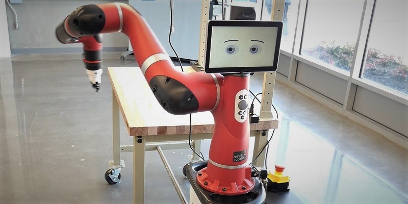

There are many makes and models of cobots, but the model in our story is a Sawyer robot by Rethink Robotics. This is a single-arm, 7-axis model, with two embedded cameras, a control cabinet with I/O, powered entirely by 1-ph 120v power, and equipped with a tablet display used for programming and for viewing operational status. This model has a 1260 mm reach and a payload capacity of 4kg.
Sawyer in action
Figure 1. Sawyer cobot in motion

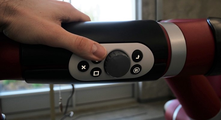

Jogging the robot is not as precise as on a normal cartesian teach pendant, but it is much faster. The wrist and base contain a set of buttons that release the motor brakes and allow manual manipulation with minimal force - this is the circle icon button in Figure 2. The buttons also provide access to updating other instructions and executing the program.
Sawyer wrist controls
Figure 2. Wrist controls for jogging and recording points.
Since the robot is jogged manually, it is more difficult to maintain precise orientations of the tool. This is the main reason why cobots are an ideal solution for jobs that aren’t incredibly precise, or those tasks which may be able to be taught by hand.
Two common cobot case studies are welding and machine tending, where an experienced technician may manually force the robot hand into the proper position - this may be much easier than attempting to numerically calculate xyz and angular coordinates that determine how the workpiece or weld tool is to be placed.
In previous programming experiences, it has taken at least a minute, usually more to jog a robot to a proper position then record the point, even at full teach speed. In this instance, all points were recorded in a matter of seconds once we became accustomed to navigation.
If more attention to precision is required, or orientation adjustment beyond what manual motion can accomplish, the coordinates can be numerically adjusted.
For those of us who are accustomed to the deadman switch for jogging access, no such switch exists. The button on the wrist is enough to unlock the brakes and allow 2-handed control of the robot.
This sounds easy, but warning - it took me a good few minutes of twisting the joints before I felt like I could easily swing from point A to B. Attempting to coordinate all 7 axes is harder than it sounds.

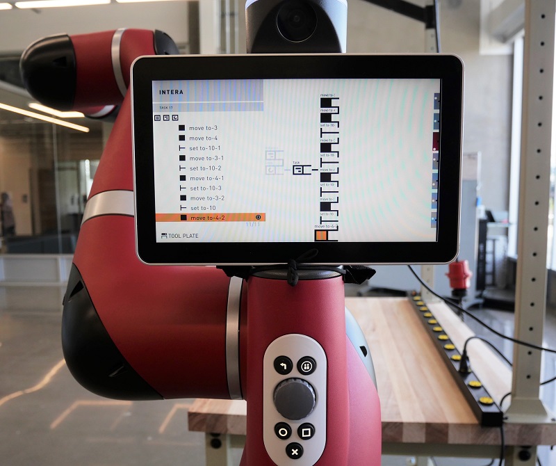

Cobot program
Figure 3. The touch screen displays the program in a flowchart diagram, rather than lines of text commands.

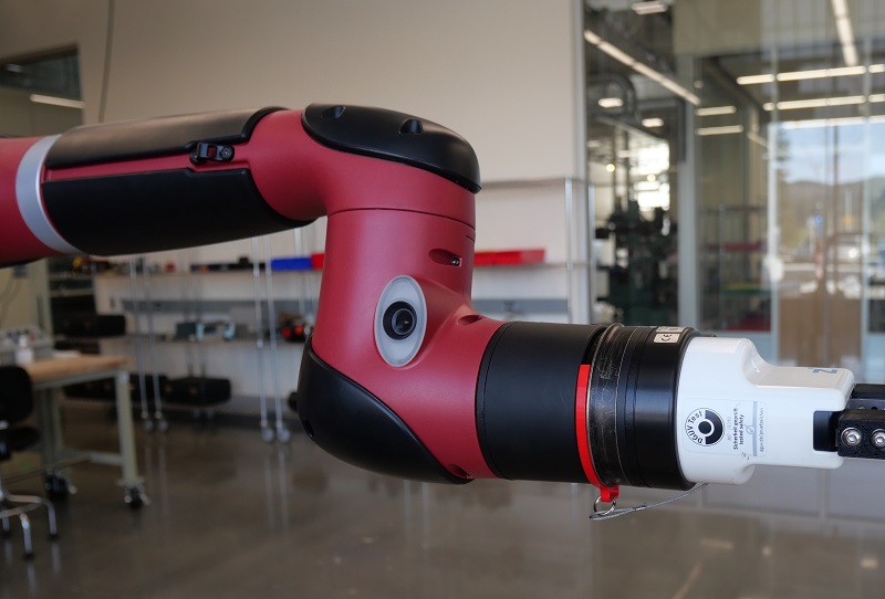

This robot also contains two Cognex cameras, one above the touch screen and one near the wrist joint. These cameras are used for robot positioning and orientation relative to the environment outside the robot, or by the workpiece itself.
Cognex camera
Figure 4. Cognex camera installed near the end effector.

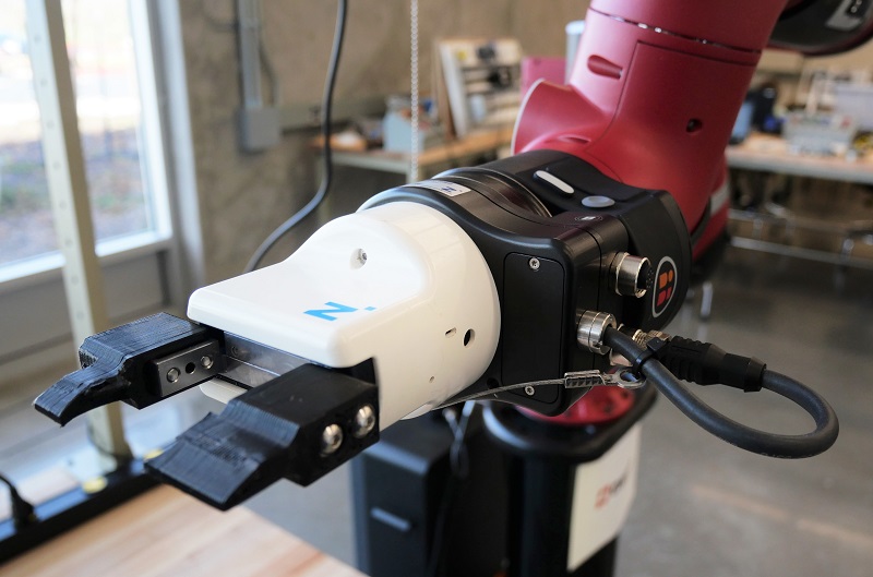

Cobot gripper
Figure 5. The gripper plate allows many different end effector options, this one with custom 3D printed claws.
