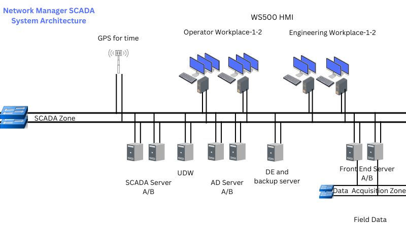

The following main applications and services-like database management system (DBMS), authentication/authorization, data acquisitions, and engineering tool are part of Network Manager SCADA System:
  • RCS Application running in application servers
  • Avanti for real-time database management
  • SCADA servers: Red Hat Linux (nmaas01,nmaas02)
  • Utility Data Warehouse: Red Hat Linux (nmaudw01), RAID Controller, Oracle for archiving
  • PCUs also called Front End Protocol Handlers (nmapcu01 and nmapcu02)
  • WS500 HMI Client for graphical display
  • Active Directory Servers (nmaad01 and nmaad02) for network and operator related authentication and authorization
  • Data Engineering (DE) servers (nmade01) for engineering related work
  • HP Data Protector for system image backups and restoration
Network Manager SCADS system configuration and architecture
Figure 1. Network Manager SCADA system configuration and architecture.

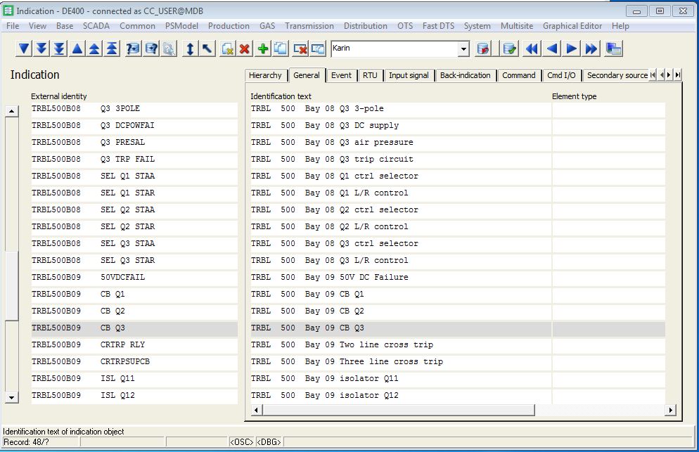

The DE400 is the data engineering application running on Windows Server 2016 used to enter data into the Network Manager control system. Network control systems require an immense amount of static information like text and symbols describing the network components. The information consists of descriptive data and of displays representing the network. Both forms of information need to be consistent, easy to enter, and easy to update. Drawing the network specifies the topology (electrical connectivity), and the data for each object is then entered using object-specific forms called DE Form, as seen in Figure 2.
DE400 Form for entering object information like breaker and isolator
Figure 2. DE400 Form for entering object information like breaker and isolator.

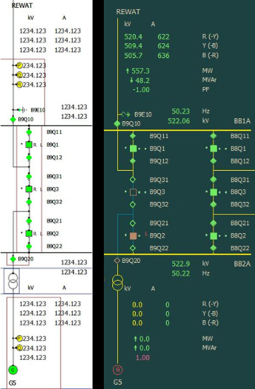

The graphical components are objects that are not network components, but are required for the picture layout, e.g. labels, static texts, navigation buttons, symbols, lines, etc.
network topology and components created in GED and Realtime Display in HMI WS500
Figure 3. Network Topology and components created in Graphical Editor (GED) on the left and Realtime Display in HMI WS500 on the right.
Referring back to Figure 2, the single bay named B09 with three individual breakers (CB Q1, Q2, and Q3) was created. Now in Figure 3, they can be seen as the squares in the center listed as B9Q1, B9Q2, and B9Q3. This is a part of a 500 kV switchyard, one-and-half busbar scheme. In this bay, one transmission line and one generating unit are connected.

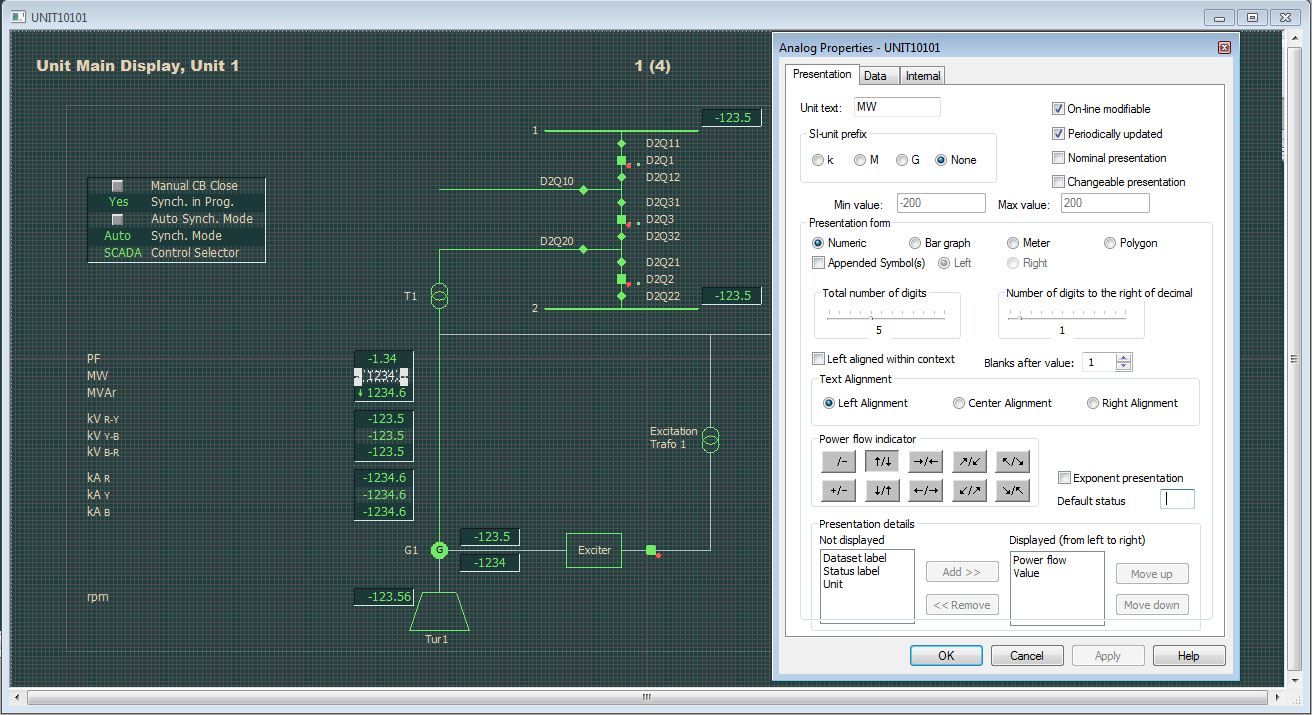

Creation of display in page template in PED500 tool for Hydroelectric Unit
Figure 5. Creation of display in page template in PED500 tool for Hydroelectric Unit.

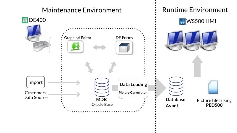

After all the work that has been done in the DE Form, such as object information entry and creation of busbar topologies including station, bays, and elements, as seen in Figure 1 and 2, it's time to populate all engineering work saved in the maintenance database (MDB) into the SCADA applications servers running the ABB proprietary database called Avanti. All data from MDB and pictures created in PED500 are available in the Avanti database after population. All the real-time information from the process is saved in the Avanti database, and database information is fetched by WS500 HMI graphical display.
population of new dataset from maintenance to runtime environment for operator
Figure 6. The population of the new dataset from maintenance to runtime environment for operator
