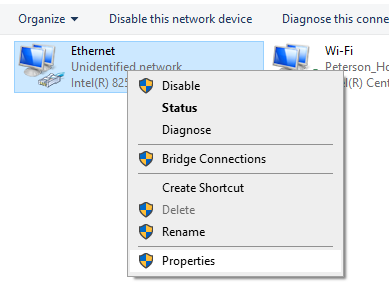

In the PC settings (assuming a Windows computer), we can access the Network and Internet Settings. The ‘Network Connections’ menu provides a list of your currently installed adapters with red X indicators by all unconnected adapters.
Figure 1. Accessing the properties of the Ethernet adapter. Image used courtesy of the author
Right-click on the Ethernet adapter. If you are instead using a removable adapter, like a USB-to-Ethernet module, be sure you are selecting the proper one.

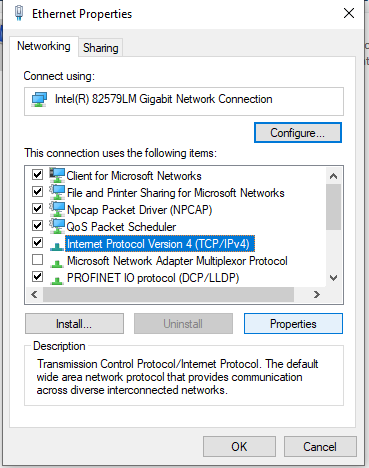

Enter Properties and locate the IPv4 properties tab.
Figure 2. Accessing the IPv4 properties of the Ethernet adapter. Image used courtesy of the author
In this menu, you can change the IP address to match the address of the target device, although be sure the last number (octet) is different.
Now, you should be able to go online in the proper IDE and change the IP address of the target device, if necessary; the factory default probably isn’t ideal for your own application.
