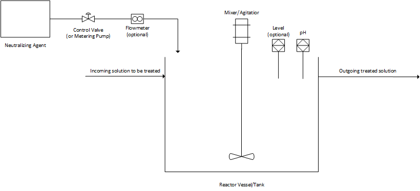

To recap from my previous article on the applications and challenges of pH control, Figure 1 shows the basic setup of a neutralization reaction realized on a process scale.
The subsequent sections will explore variations of this setup, but they all share some common components, namely:
  • A reactor vessel with a mixer or agitator
  • Chemical feeds that can be turned on and off in order to add the neutralizing agent (titrator)
  • A way for the solution requiring treatment (titrand) to enter and exit the reactor vessel
  • And, of course, a controller such as a PLC or DCS
Figure 1. Basic setup of a neutralization process
Note that in the following scenarios, it is assumed that the titrator and its concentration are both constant and known.

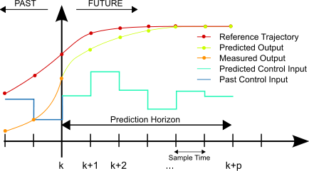

Instead, certain algorithms may need to be employed to determine an appropriate,variable feed rate for the titrator. This could be as simple as a few if/then statements or as complicated as a model predictive controller. The variability in the solution to be treated, along with the deviation tolerance from setpoint for the process, can help determine how complex the algorithm needs to be.
Figure 3. Model predictive controllers can help avoid overshoot in non-linear systems. Image used courtesy of Martin Behrendt [CC BY-SA 3.0]
Regardless of the specific control strategy employed, additional analytical measurements may strengthen its resolution, such as an upstream pH or flow transmitter. Measurements such as these can be used in a feed-forward fashion, in the case of the pH probe, or to help adjust feed rates based on variable incoming flow, in the case of the flowmeter.
