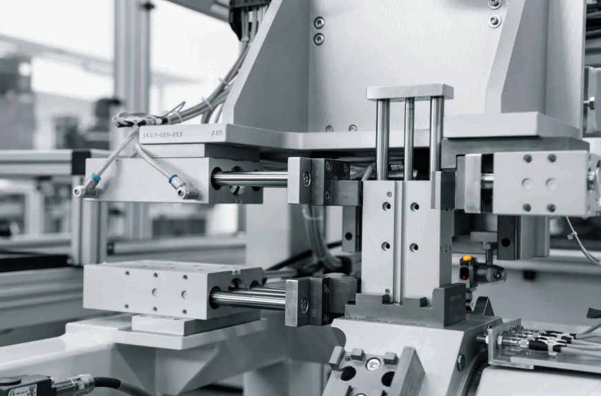

Pneumatic cylinder motion is a common subject of monitoring and data processing to ensure long equipment life.
Figure 1. Pneumatic cylinder motion is a common subject of monitoring and data processing to ensure long equipment life. Image used courtesy of Festo

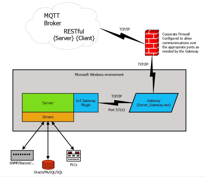

Path of bi-directional data flow from physical (at the bottom of the image) to cloud connection (top).
Figure 3. Path of bi-directional data flow from physical (at the bottom of the image) to cloud connection (top). Image used courtesy of Kepware

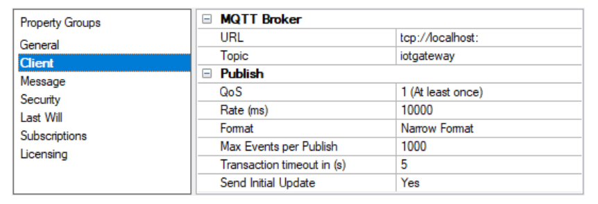

There are two ways to add the MQTT function to Kepware. One is using the MQTT client driver and the other is using the IoT Gateway option
For this example, I’m going to use the IoT Gateway because I just want to publish data and not subscribe. Configure the IoT Gateway port and security certificate in the Kepware settings at the time of installation. The certificate requirement will depend on which broker you are using, for example, AWS allows you to download the certificate that can then be installed in Kepware—Hivemq public broker doesn’t require a certificate.
Create a new agent: within the agent configuration, you will be able to enter the broker URL, username, password, topic, and QoS settings. The message section will allow you to format the message that will be sent to the broker. Kepware uses standard JSON formatting for MQTT messages—one of two templates can be selected depending on the complexity of the message you are sending.
Once the agent is configured, you can then add the tag that was configured earlier. A wizard will open and allow you to select pre-configured tags. The published rate is important, if you publish too often, you might overload the broker or your PLC. It is best practice to only publish when the data changes. Kepware will take care of the connection message and disconnection messages when needed.
