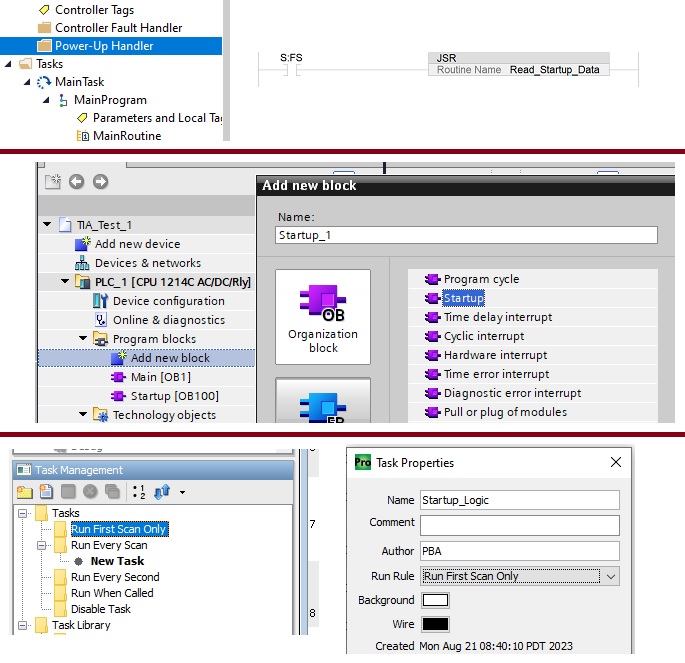

Startup Bits or Flags
Nearly every PLC program has a built-in status bit that is energized on the first scan cycle. The startup bit can be attached to outputs or subroutines to examine any process information that is important before the program officially begins running. Perhaps all outputs in a module must be de-energized at the start of a program, or counters reset to zero to initialize the variables. This is all done via the startup bit.
Use caution to never place any instructions after this bit that is intended to perform a function sometime after startup, as it will not happen again. Additionally, use caution whenever attaching this bit to functions targeted for networked devices. If there is a network delay of more than one scan cycle (which is very likely), the commands may not execute at the end device.
Examples of this startup bit or tag include:
  • Allen-Bradley (Rockwell): S2:1/15 (for RS500) or S:FS and the Power-Up Handler task (for Studio/Logix Designer5000)
  • Siemens: SM0.1 (for S7-200), organization block OB100 (for S7-300/400/1200/1500). This is not a bit itself, but rather an entire startup routine.
  • Mitsubishi: M8002 (for FX series)
  • Automation Direct: SP0 (for DirectLogic DL series), SBR-001003 or use the ‘First Scan Run’ task property (for Productivity series)
  • Omron: 253.15 (C200 series), A200.11 (CJ series), P_First_Run (NJ/NX series)
PLC startup handling methdos
Figure 1. Examples of startup bit (or task) strategies for various controllers: Logix families from Rockwell (top), TIA Portal from Siemens (middle), and Productivity from Automation Direct (bottom). Image compiled by the author

This is similar to a startup bit, or flag. That single bit is only energized for one scan cycle, so it can be used to jump into one subroutine. On some PLCs, there is already a first scan routine (like the OB100 for Siemens), or a task type that can be set to “first scan only” (see the Automation Direct Productivity series). For Logix processors from Rockwell, a "Power-Up Handler" task can contain programs and routines dedicated to certain functions like clearing faults at startup.
Note that these flags or routines are always internal memory addresses, that is, they exist in the memory of the PLC. That means they will be energized the moment the PLC starts, regardless of the connection to the computer, any I/O devices and modules, or external equipment, so this is reliable.
Depending on the PLC, this task set or single bit may also energize when the CPU is switched from Stop (or Program) to Run mode, which also indicates the starting point of the program. So if you expected it to only energize on a full power cycle, this may take you by surprise and cause unexpected results.
If you want to diagnose or verify this behavior, you can simply use the startup bit or flag to increment a counter or run an off-delay timer for a short duration. That counter or timer current value should be visible for sufficient time to verify that the startup bid did, indeed, energize for a moment.
