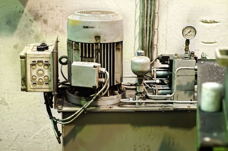

Figure 1. An industrial three-phase electric motor.
Usually, these devices are paired with three-phase motors, although one-phase and even DC motors can sometimes be seen paired with these devices. These starters have overcurrent limiting breakers, but they have unique properties that separate them from standard circuit breakers.

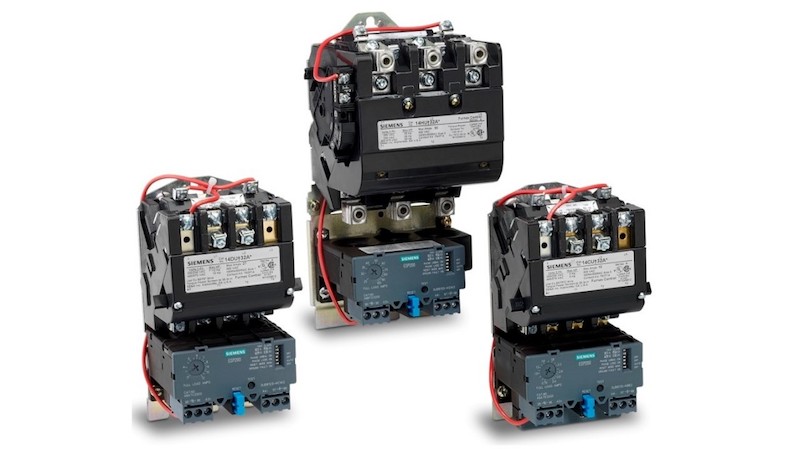

A typical motor starter consists of two pieces designed to enable the on/off switching action and stop the motor automatically in case of overcurrent.
The motor trip class refers to the number of seconds for which the starter will allow high current during start-up, but various applications may affect which trip class is required.
Figure 2. NEMA starters and contacts. Image used courtesy of Siemens
