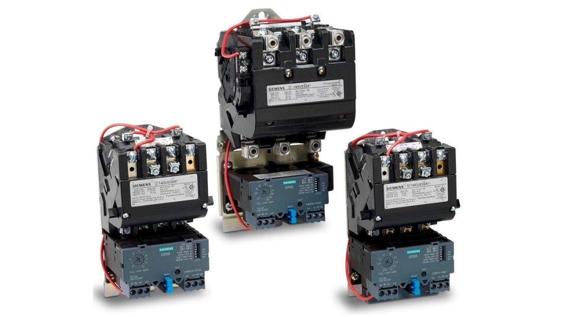

This article will focus on motors running on AC power as they are the most common in a manufacturing setting. Motor contactors are used in a variety of applications to provide power for electric motors. They fall into one of two categories; motor starters and motor contactors.
Motor contactors are the most basic of the two devices and work by allowing current to the motor based on an electrical signal. Motor starters contain a motor contactor in tandem with an overload relay.
NEMA starters and motor contactors. Image courtesy of Siemens.
A motor contactor functions similarly to a large relay. A signal is sent from the control panel to the contactor; a magnetic field is created from the signal and used to pull the contactor together and complete the circuit. Once the circuit is complete, current flows to the motor give it the needed power to run.
Motor contactors are the cheapest option for automated motor control. They lack some features that may be important to the overall functionality of the system. Motor contactors can only break or complete a circuit to the motor and do not monitor it.
Motor starters work identically to motor contactors but have the added advantage of overload protection. Overload protection can help save motors from damage when motor overloading occurs. When a motor overloads, it starts to draw more amperage.
When the amps climb to a certain level, an overload relay kicks the contactor out of the circuit. Motor starters can save motors from overheating and becoming damaged. Motors can be expensive and challenging to replace, leading to increased downtime and lost production, so in most cases, the extra initial cost is justified.

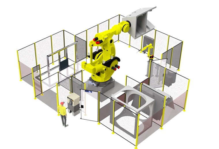

Robotic Applications for Motor Contactors and Drives
Motor contactors and variable frequency drives play an essential role in most robotic cells. They are often used to drive conveyors and other electric motors in the system. The application of an electronic motor determines what type of device should be used for optimum functionality.
A robot working in a robotic cell. Image courtesy of Acieta.
For applications involving something simple like a product conveyor, that only needs to turn on and off, and a motor contactor/starter will work fine. More complex motor control will need to be taken care of with the help of an AC drive.
Cost is often a big determinant in whether a drive or a contractor is used. Although drives cost more initially they are often more economical in terms of potential downtime and energy use. Contactors are the simplest of all motor control systems but do not protect motors from overload issues.
To protect a motor during an overload situation, a drive or motor starter is necessary to protect expensive motors from damage. When designing a cell, it is best to look at each device's pros and cons before making a final determination on what is best for the overall functionality of the cell.
