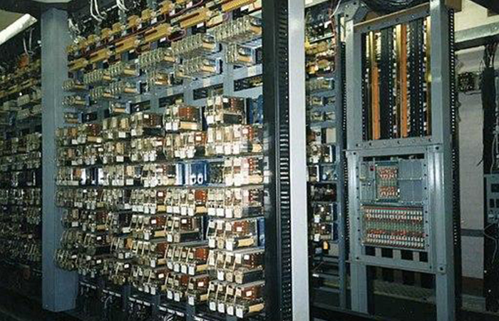

In the 1960s, computers were ruggedized for industrial environments where they were implemented to automate simple processes by controlling inputs and outputs. These digital controllers were quickly replacing large arrays of electro-mechanical relay switches — devices that mechanically open or close a circuit depending on whether or not they are energized with an electrical current — that had been hardwired to perform the same logical function as the new digital controllers. If the end result was the same, why then were manufacturers changing to a different technology?
Utilizing PLCs in Place of Relays
The answer for the switch from relays to these new programmable logic controllers (PLCs) lies in the fact that PLCs were vastly more versatile than their hardwired relay cousins. Because the relays were hardwired, making a simple change to the logic involved laborious tracing and rerouting of wires which was time-consuming and prone to error.
Figure 1. A pre-PLC relay room
The PLC allowed engineers to instead make these changes digitally within the programming of a controller and immediately see a change in output.

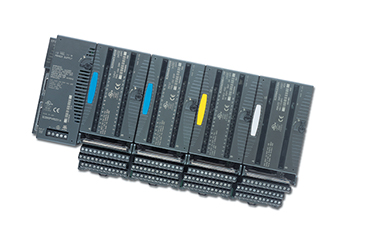

Figure 2. The Emerson VersaMax is an example of a typical PLC. Image courtesy of Emerson.
PLCs radically improved efficiency and took up a fraction of the cabinet space compared to relays.

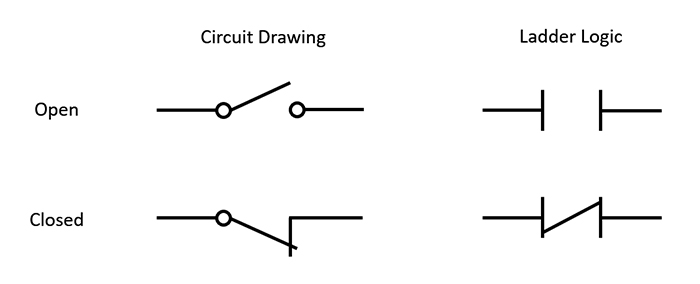

A typical PLC is programmed in ladder logic. Ladder logic is a visual programming language that graphically mimics the way circuit diagrams were drawn for the hardwiring of relays. Notice the similarity in the symbols below used to indicate normally open and normally closed contacts:
Figure 3. Ladder logic vs. traditional circuit symbols

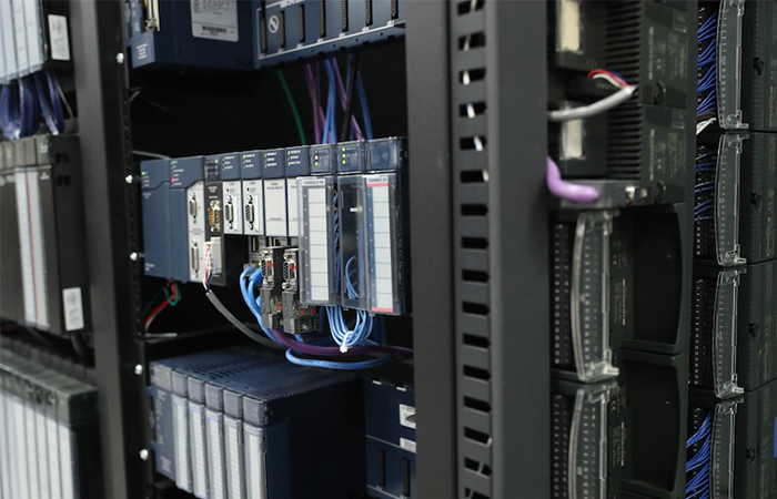

Figure 4. The PACSystems™ RX3i rack-based controller. Image courtesy of Emerson.
