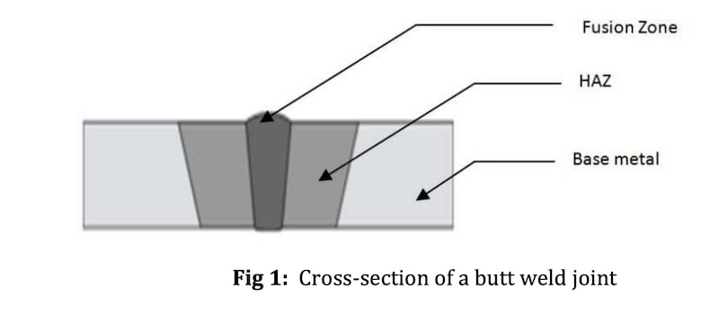

In an ideal process, 100% of the energy would go directly into the material to accomplish the desired result. However, it is currently inevitable that some energy is wasted and will affect the area around a cut or joint.
Figure 1. Schematic of a heat-affected zone (HAZ). Image used courtesy of Advancement in Production Engineering & Management (APEM) [PDF]

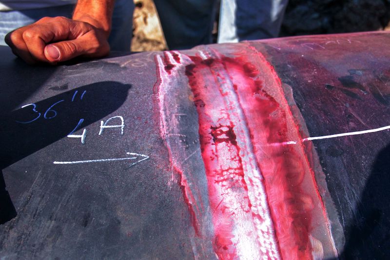

Cracking is less common than porosity, but is probably a larger or more important concern in welding. A part is usually acceptable with some degree of porosity, but cracks are typically unacceptable. Cracks are often caused by grain structure formation or the stresses formed by thermal expansion and contraction. Some manufacturers or designers might not use a material—or would use a different fastening method—if it is prone to cracking.
Figure 2. Cracks on a welded pipe after a liquid penetration test.
As a material is heated from a process such as welding, it expands. If the joint and surrounding area cools quickly, the material shrinks and generates tensile stresses in the joint. These stresses propagate cracks or are stored in the material as residual stresses that reduce the strength of the joint. Additionally, cooling steel too quickly can form martensite, which can make a joint brittle and helps propagate cracks.
Cracks can also occur as the weld solidifies and forms oriented dendrites along the outside of the joints and equiaxed dendritic grains toward the center. Oriented dendrites increase crack propagation. Having a wider equiaxed grain structure in the center of the weld reduces crack propagation.

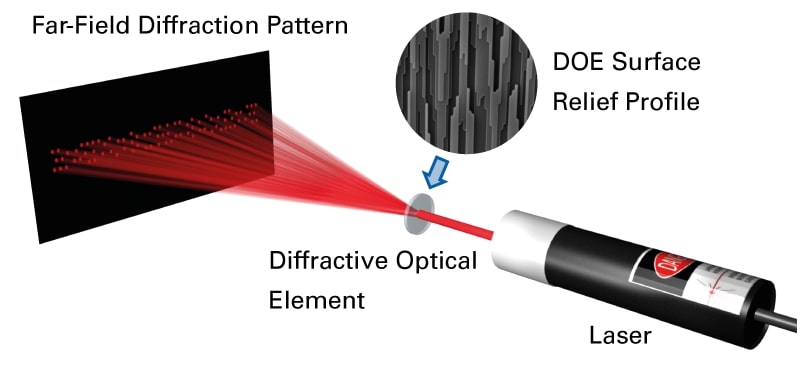

Diffractive optical elements (DOE) splits a laser on either side of the weld to provide a solution similar to having two lasers. This solution would also increase the time and cost to design and make the DOE while limiting the weld geometry, direction, and beam shape.
Figure 3. The DOE principle. Image used courtesy of HOLOEYE
