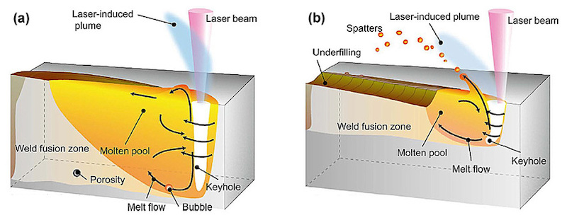

Poor melt flow can cause multiple problems, such as spatter and inconsistent welds. Spatter is when material is ejected from the melt pool, often caused by vapor escaping the keyhole. This material can land on other joint areas or parts, solidify, and cause various issues.
Figure 1. A schematic showing melt flow. Image used courtesy of ResearchGate
Inconsistent welds, such as undercuts and humping on the weld seam, can occur when the velocity of the melt is too high. When welding, liquid materials flow from the leading edge, around the laser beam, and surpass the vapor capillary toward the trailing edges of the melt pool. Welding at high speeds increases the velocity of this liquid material flow and the possibility of inconsistent welds.
