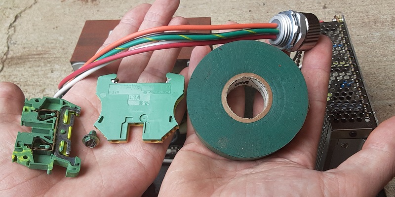

Grounding devices and wires
Figure 1. Normal grounding methods showing with colored insulation, tape, grounding screws, and grounding terminal blocks, all showcasing the typical green or green/yellow coloring.
A conductive ground terminal on the panel must provide a secure connection to equipment and to all the metal parts inside (14.2, 3).

The color green, or a selection of text indicating ‘Ground’ or ‘Gnd’, denotes the requirements for grounding conductors. The wire must be uniquely insulated by green or green/yellow insulation, or if the insulation happens to be any other color, it must have green tape at the ends. All grounding screws and connection points must also be green colors and/or have clear labels with the selection of appropriate text. (17.1-3)
