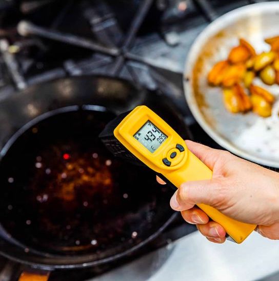

Infrared light used in many cooking thermometers
Figure 5. Many thermometers in cooking use infrared light. Image used courtesy of ThermoWorks
Infrared Sensors
The light beams produced by infrared sensors are not visible to the human eye. Infrared detection was invented several decades ago, and it has remained a popular option in industrial automation because of its energy efficiency. They are particularly well suited for environments with high contaminants, such as dust. On the other hand, the fact that the light beam is not visible makes the installation and alignment more complicated.
Infrared sensors are also good options for detecting opaque surfaces and dark-colored objects. They too can penetrate certain materials, making it possible to see things inside containers.
Infrared sensors provide the most extended detection range among the different colors in the spectrum.
