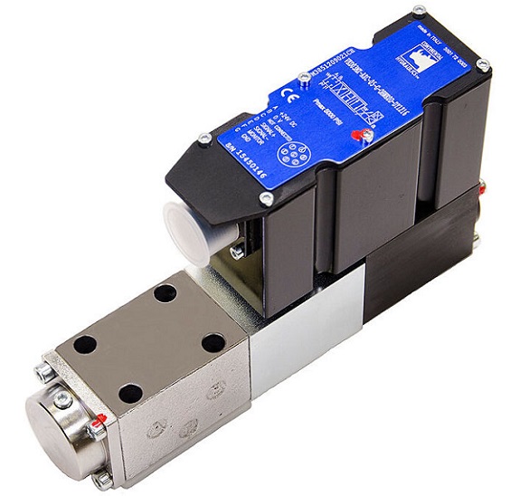

Likewise, the scale of data for the Output must also be understood. If the signal is directly attached to an analog output address for a proportional valve, the output min/max should relate to the resolution of the analog output, maybe the same 0-65535 range, or maybe rather in the -32,768 to 32,767 range if the output is capable of negative voltage outputs.
Servo controlled proportional valve
Figure 2. An example of an output device might include a servo-controlled proportional valve for precise hydraulic motion. Image used courtesy of Continental Hydraulics
