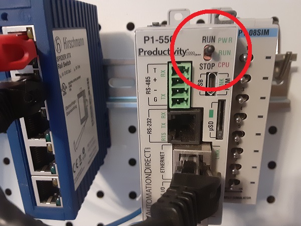

PLC with only Run and Stop modes
Figure 1. A PLC with only Run and Stop modes as physical switch options. Author’s image

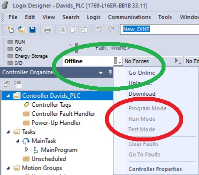

Online vs operating mode selections
Figure 2. Online/offline connections (green) differ entirely from the operating mode selection (red). Author’s image
Can’t I just Go Offline to Stop the PLC?
Changing the mode remotely from the software requires being online with the PLC. If you “disconnect” from the PLC, it will NOT place the PLC in Stop mode. Furthermore, you will no longer be able to change modes remotely at all until the connection is re-established. Going offline will absolutely not stop the PLC from executing commands.

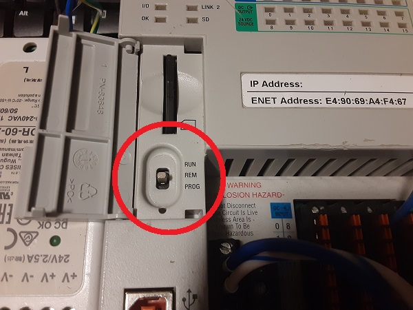

Not all PLCs have the same two operating modes; Rockwell PLCs, in particular, are known for their three-mode selection options appearing on the physical CPU toggle switch: Prog, Run, and Rem (remote run). However, Rockwell’s Studio and Logix Designer environments have a different set of three modes (see Fig 2): Program, Run, and Test… But what do toggling those actions mean?

Figure 3. Run, Rem, and Prog allow the user to lock out or allow online edits, or to place the PLC in stop mode. Author’s image
So far, we have been calling Stop mode Program mode. This allows the PLC to have the program loaded, but also stops execution of the program inside the CPU. In other words, Prog is the same as Stop for other brands.
What is Different Between Run and Remote Run Modes?
By selecting either the toggle switch (smaller CompactLogix) or key (ControlLogix) on the front of the Rockwell CPU, system engineers can determine whether or not the CPU is locked from any remote changes or online edits. Run mode restricts the CPU to not allow online editing of the program. More often than not, the PLC should be left in Rem mode which will still execute the program, but won’t allow edits from the online connection. Monitoring of tags and logic may still be done in Run mode.
If the PLC is functioning correctly, via an established online connection, but you are unable to make any program edits, then verify that the key/switch is in Rem mode.
Another point to note, the software IDE in this case will show Run mode, regardless of whether the key/switch is in Run or Prog on the actual PLC itself.

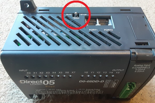

This can appear under other terminology as well. For example, on some Direct Logic PLCs, the switch allows a Term position, or “remote terminal,” which allows online edits, while Run provides a read-only mode for monitoring, but with no changes.
Terminal or 'term' mode to program online
Figure 4. Term mode means the same as Rem, which allows the PLC to accept online edits. Author’s image

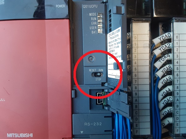

Some PLCs offer a third option where the switch on the CPU is not an operation mode itself, but rather a reset function to clear faults or to install parameters after major hardware updates. This is usually indicated with a Reset as a switch position (Mitsubishi Q-Series CPUs, for example).
Reset switch position on some PLCs
Figure 5. A third Reset position, as shown on some PLCs. Author’s image
