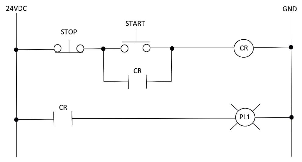

In industrial controls, there is a fundamental approach to allowing operators to engage with automation machine systems: the start-stop control circuit. The start-stop control circuit allows a hands-free approach to starting an automated machine or process by pressing a pushbutton switch. The pushbutton switch is only a momentary operation where the operator releases the switch after pressing it.
To accomplish a process control function, a latching feature is required. The latching feature consists of having an electromechanical control relay (CR)’s contact wired in parallel with the start pushbutton switch. The CR coil is energized by the current flowing through closed contacts of the series-wired start and stop pushbutton switches.
The parallel wired CR’s NO contact will provide an electrical current that will maintains a sealed pathway around the start pushbutton switch once it is released and returned to open. The CR’s second NO contact wire on the second rung of the control circuit will close, thus turning on the electrical load, here a pilot lamp (PL), is wired to it. To turn off the PL electrical load, press the stop pushbutton switch. Figure 1 illustrates this start-stop relay ladder control circuit.
start-stop control relay ladder circuit

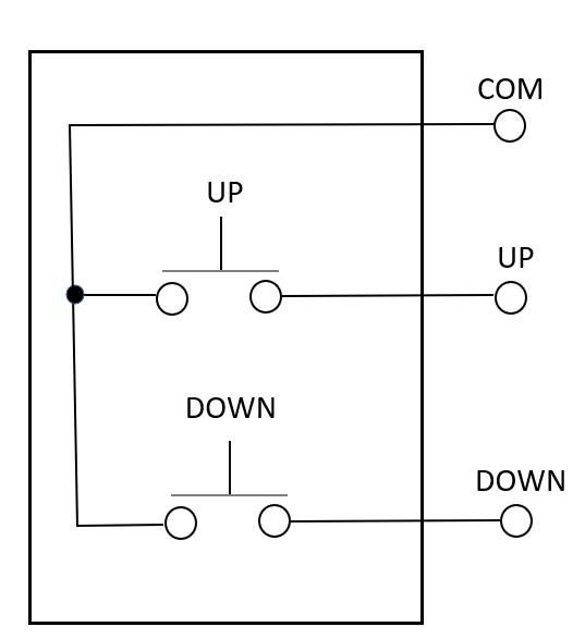

The control station pushbutton switches provide the control signals to the Arduino to operate the LED. It is important to have the control station switches wired properly to ensure the start-stop LD program works correctly. Therefore, attaching the wires to the correct terminal block points of the switch box will achieve correct control operation. The electrical symbol for the switch box is provided in Figure 3.
up-down control station switch box electrical symbol
Figure 3. The up-down control station switch box electrical symbol

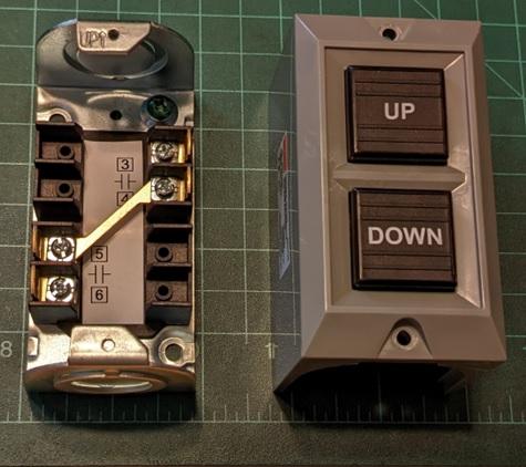

By removing the top and bottom fasteners, the switch box cover is removed. Push the top metal knockout of the box so that three electrical wires may pass through it. Be sure to sand the metal knockout edges to prevent cutting the insulation from the wires.
With the removal of the cover, the terminal block for attaching electrical wires can be achieved. Dupont or 26 AWG solid wire is attached to the three terminal screws. The shorting bar provides a common point for switching either high side voltage or ground. For the Arduino PLC, +5 VDC will be wired to the shorting bar, thus switching high-side control voltage signals to digital pins 2 and 3. Figures 4 and 5 show the cover removed and electrical wires attached to the control station switch box.
switch box cover removed
Figure 4. Switch box cover removed
attachment of electrical wires to the control station switch box
Figure 5. Attachment of electrical wires to the control station switch box

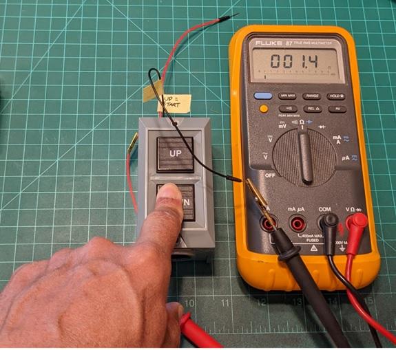

After replacing the cover on the switch box, take an ohmmeter and perform an audible continuity test of the electrical wiring attached to the up and down pushbutton switches. Attach the ohmmeter between the common (COM) wire and either of the other electrical wires. Press and hold one switch to hear an audible continuity tone. If the tone is heard, proceed to test the other wire and switch. Figure 6 illustrates testing the control station switch box electrical wiring with an ohmmeter set in audible continuity mode.

Congratulations, you have a functional control station switch box to wired to your Arduino PLC! Add labels to the three attached electrical wires for identifying the two switches and the COM. Secure the cover with two removed fasteners. The next step of the OpenPLC project is wiring the switch box to the Arduino.

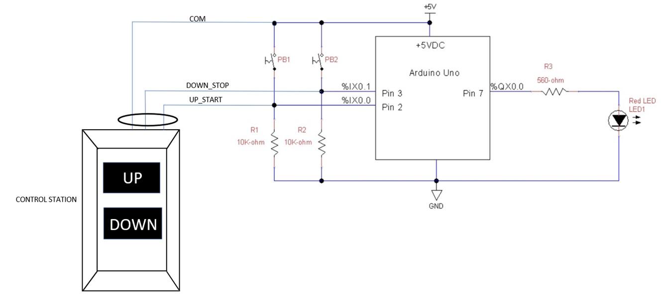

The next in the project is to wire the control station switch box to the Arduino. The COM wire will be wired to the +5 VDC rail of the solderless breadboard. This breadboard will also be used to contain the two tactile switches that will operate the program if you do not have an enclosed switch box.
The ‘up’ electrical wire from the switch box will be inserted into the breadboard cavity where digital pin 2 of the Arduino is wired to the 10 Kilohm (KΩ) pulldown resistor. The ‘down’ electrical wire will be inserted into the solderless breadboard cavity where digital pin 3 of the Arduino is wired to the other 10 KΩ pulldown resistor. Figure 7 provides the electronic circuit schematic for wiring the control station switch box to the Arduino PLC.
If you do not have an enclosed switch box:
Simply omit the COM, ‘DOWN_STOP’ and ‘UP_START’ wires from the diagram in Figure 7, allowing PB1 and PB2 to operate the system alone.
control station switch box to arduino plc electronic circuit schematic diagram
Figure 7. Control station switch box to Arduino PLC electronic circuit schematic diagram.
With the switch box wired to the Arduino PLC, an electrical test can be performed.
Place a digital voltmeter across the R1 10 KΩ pulldown resistor. Power the Arduino by attaching a 9 V battery to the barrel connector (A USB or AC power supply will work as well). The green ‘ON’ LED will be active. Press and hold the ‘up’ switch to read approximately +5 VDC. Attach the digital voltmeter across resistor R2 and perform the same voltage measurement test using the ‘down’ switch. If a reading of approximately +5 VDC was not measured, ensure the digital voltmeter is electrically connected across the pulldown resistors. Repeat the test to ensure correct control voltage signals are being applied to digital pins 2 and 3 of the Arduino. The next part of the OpenPLC project is to build the LD program.

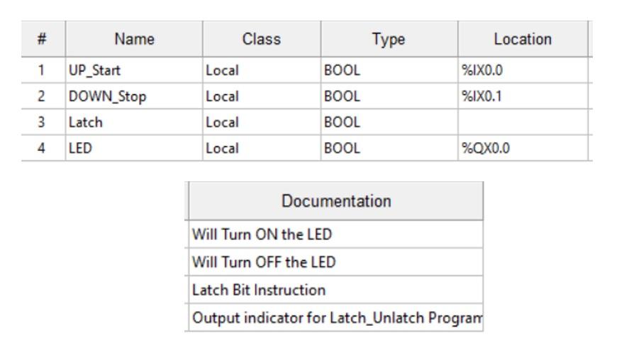

The start-stop LD program is created by referring to the relay ladder circuit presented in Figure 1. Following the OpenPLC setup instructions provided in the PLC Ladder Logic on an Arduino article, create the tag listing table using Figure 8. The documentation column provides a short description of the bit instruction used in the start-stop LD program.
start-stop tag listing table
Figure 8. The start-stop tag listing table.

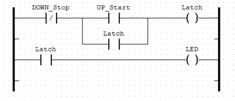

Using the tag listing table, the start-stop LD program can be built using Figure 9. To ensure the LD program will work properly, note the negated bit instruction used with the DOWN_Stop tag.
completed start-stop ladder diagram program
Figure 9. The completed start-stop LD program

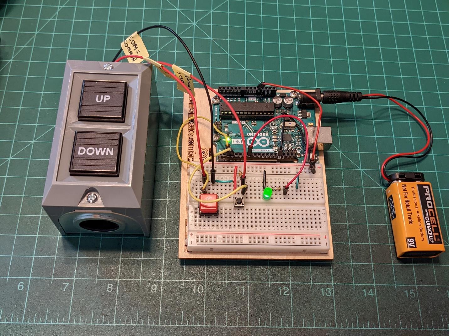

Attach the Arduino to your computer USB port. Upload the LD program to the Arduino PLC to test the final automation control operation. Using a mouse, click the Arduino logo on the OpenPLC taskbar. Select the correct USB port to upload the LD program. Once the LD program has been uploaded, press and release the ‘up’ switch—the LED will turn on. A press and release of the ‘down’ switch will turn off the LED. Figure 10 illustrates the complete OpenPLC start-stop control circuit.
Figure 10. The OpenPLC start-stop control circuit.
