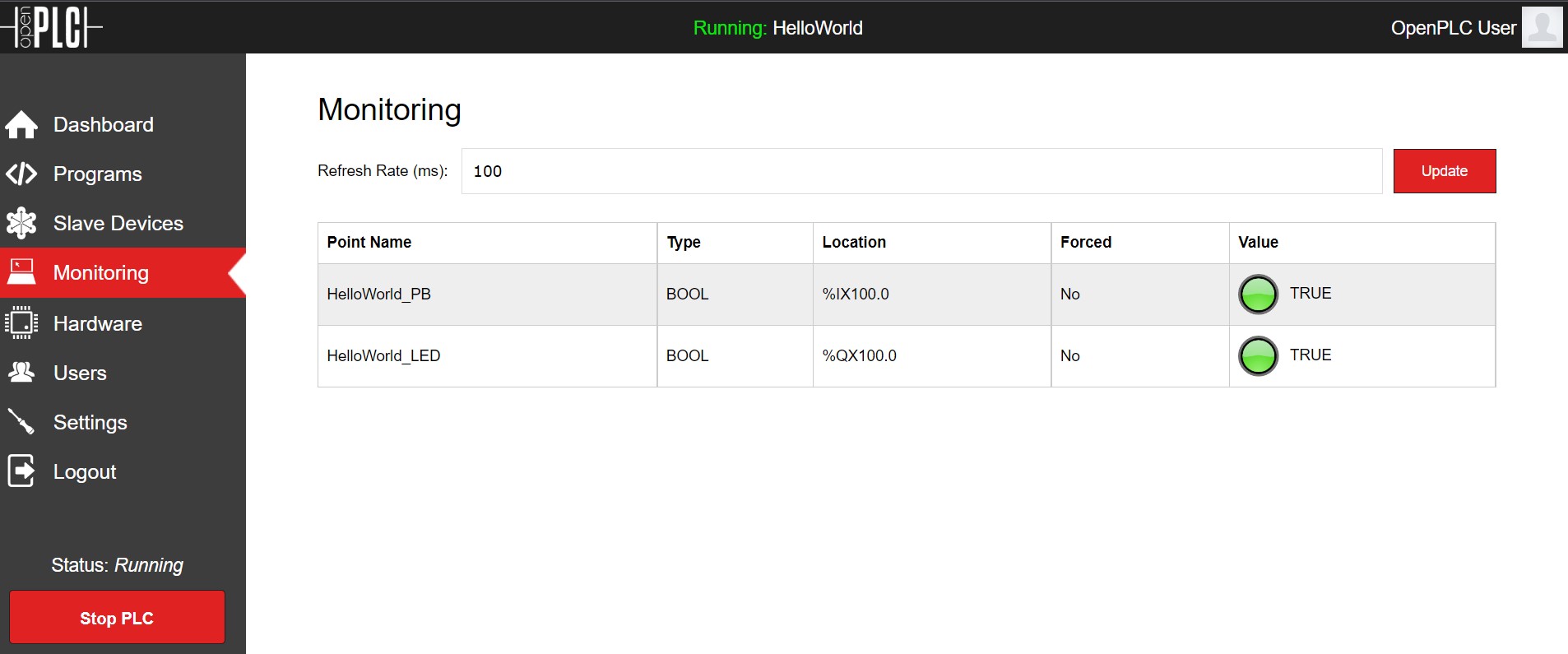

OpenPC Hello World runtime dashboard
Figure 1. OpenPLC Hello World runtime dashboard.

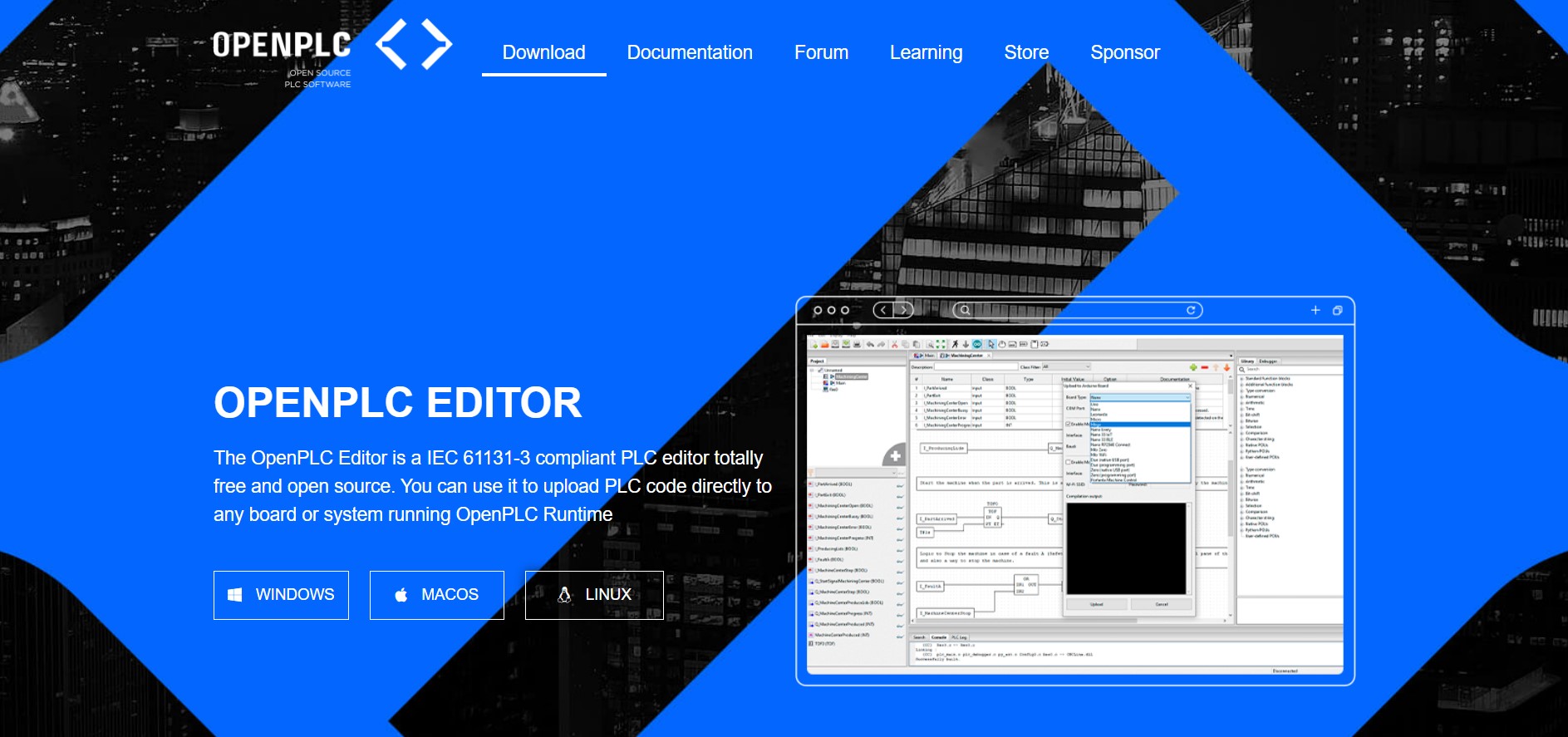

With an understanding of the OpenPLC open-source platform, you are now ready to build an Arduino Uno or compatible PLC. The first step to building an open-source PLC is downloading the development tool from the website here
Open PLC Website
Figure 3. OpenPLC website.
Select the software for your PLC development machine’s operating systems. With the OpenPLC software downloaded from the website, double-click to run the installer.

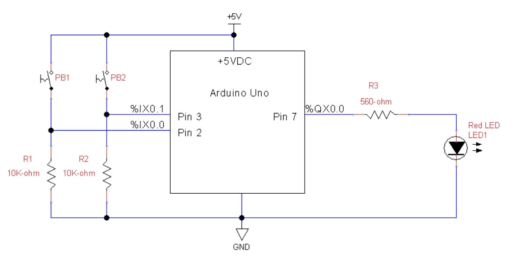

This project uses an Arduino Uno or compatible board along with a few discrete electronic components on a solderless breadboard. The Hello World PLC project lights up an LED when pressing a tactile pushbutton switch. You will wire your Uno compatible PLC using the electronic circuit schematic diagram shown in Figure 4.
Arduino Uno PLC electronic circuit schematic diagram
Figure 4. The Arduino Uno PLC electronic circuit schematic diagram.

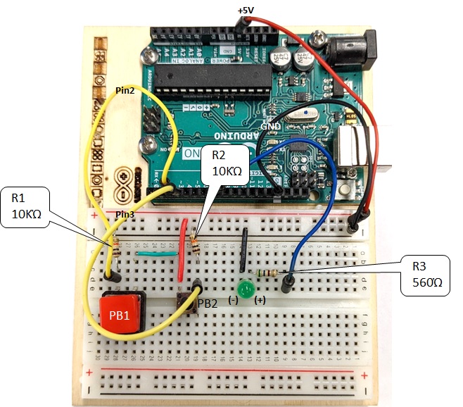

As an additional reference, here is the author’s solderless breadboard PLC shown in Figure 5.
prototype of Arduino Uno PLC wiring diagram
Figure 5. The author’s actual prototype Arduino Uno PLC wiring diagram.

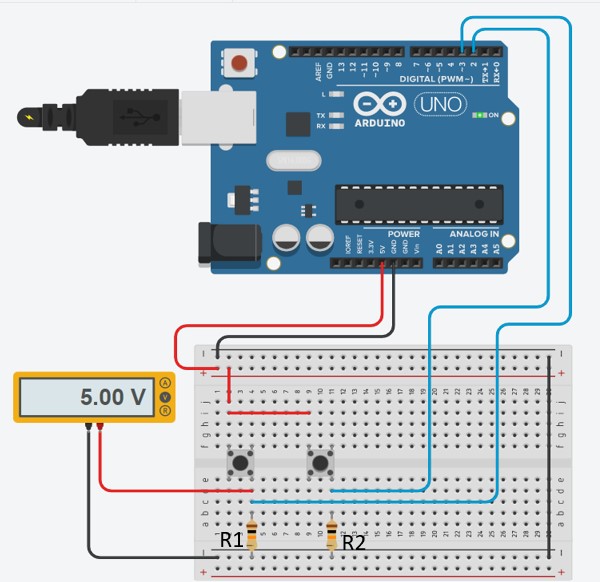

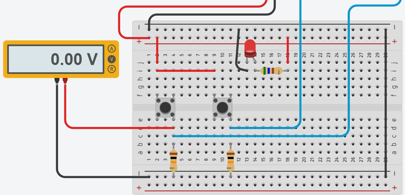

The tactile pushbutton switch PB1 and PB2 are wired as digital logic switches. When pressing PB1 or PB2, approximately +5 VDC is applied to pins 3 and 2, respectively. To illustrate the method of testing the wired digital switches, Figure 6 is presented. You will notice in the Tinkercad circuit model the digital voltmeter is attached across resistor R1. The USB cable links the Arduino PLC to the programming computer. A power-on LED will be visible on the Arduino Uno printed circuit board (PCB); this indicator signifies the microcontroller and the supporting electronic circuits on the printed circuit board (PCB) are powered on.
testing a digital logic switch
Figure 6. Testing a digital logic switch.
Place your digital voltmeter across R1 of the actual PLC prototype shown in Figure 5 and press the PB1 tactile switch. An approximate reading of +5 V should be displayed on the electrical measurement instrument’s LCD. If the voltage reading is not approximately +5 V, check your wiring and repeat the measurement. Perform the same test measurement on the PB2 tactile switch. Press PB2 to read approximately +5 V on the digital voltmeter.
Congratulations, you have two functional digital logic switches for your Arduino PLC.

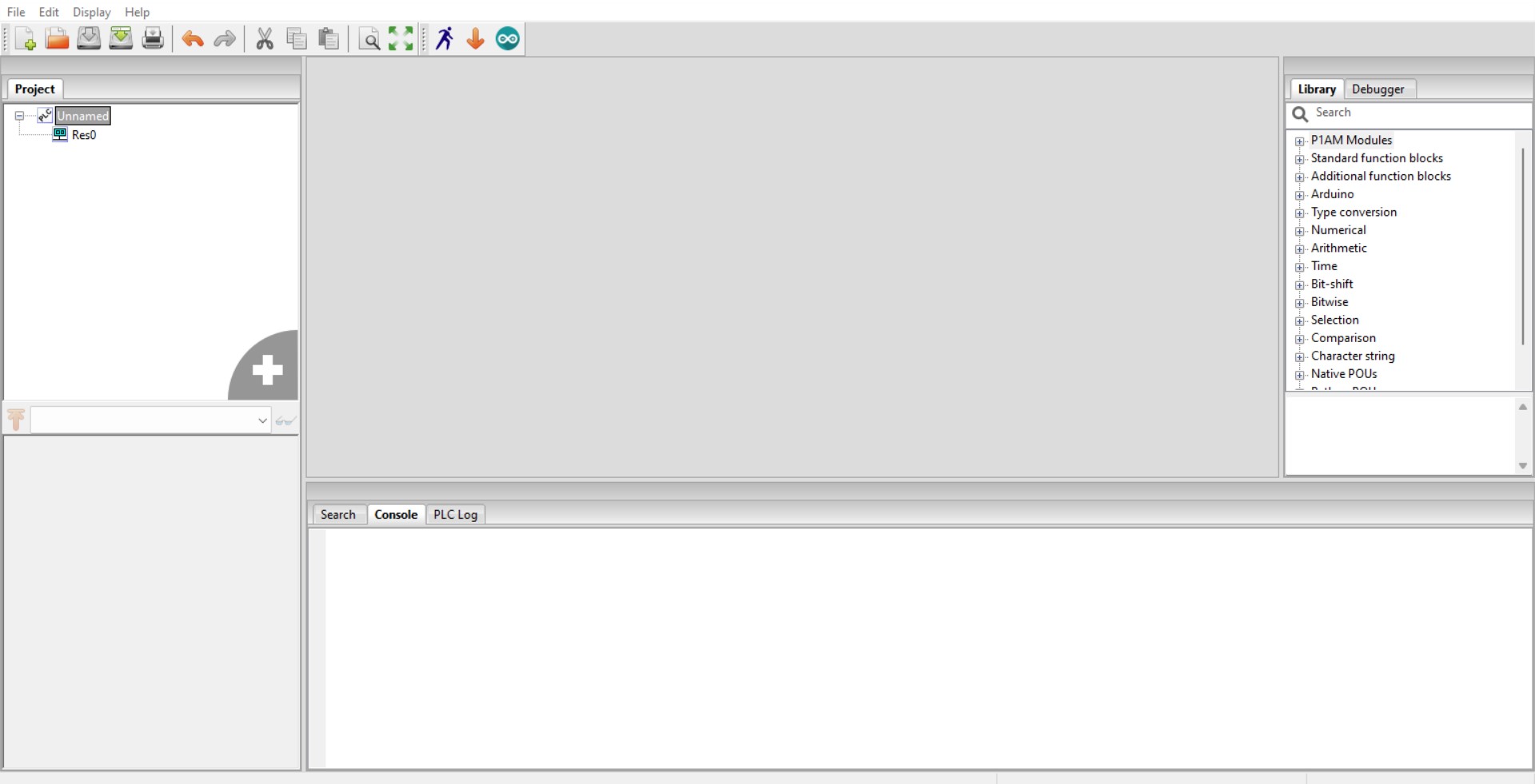

Next, right-click on the computer create a project folder (recommended in My Documents or another simple location) in which the OpenPLC-generated files are stored with the LD program. You can name the project folder ‘HelloWorld’.
With the project folder created, open the OpenPLC software and select the HelloWorld project folder, and the OpenPLC editor will appear on the screen.
OpenPLC editor
Figure 8. The OpenPLC editor.

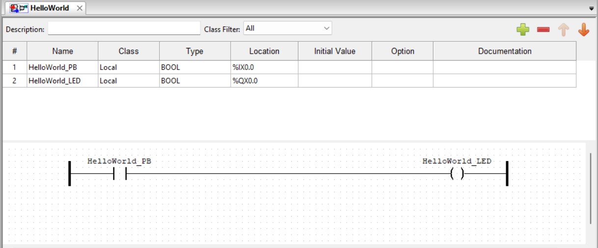

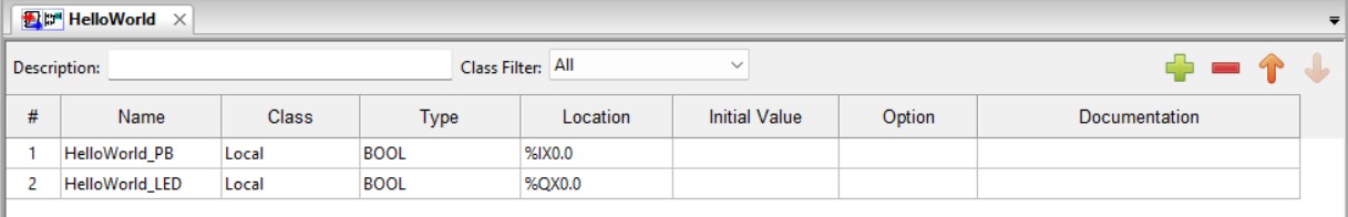

With the project box completed, you are ready to create I/O tags. For the Hello World LD, there are two tags: HelloWorld_PB and HelloWorld_LED. Click the plus sign to create the two I/O tags. Your I/O tags listing should look like Figure 10.
HelloWorld 1/0 tags listing
Figure 10. HelloWorld I/O tags listing.
You will notice the columns’ Type and Location in the I/O tags listing. Click in the HelloWorld_PB’s Type (data type) cell and select BOOL. Repeat the selection process for the HelloWorld_LED. With the tactile pushbutton switch providing digital information (ON/OFF) and the output LED indicator being commanded to turn ON and OFF, the data type is Boolean, thus the selection of BOOL. The location column is the PLC address for the specified I/O pins of the Arduino Uno. Type the addresses as shown in Figure 10.

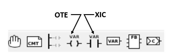

With the I/O tags listing completed, you can now create an LD program. The two primary PLC bit instructions you will use for the Hello World project are the Examine If Closed (XIC) and Output Energized (OTE) The location of these bit instructions is in the programming toolbar.
PLC Bit instructions
Figure 11. PLC Bit instructions.

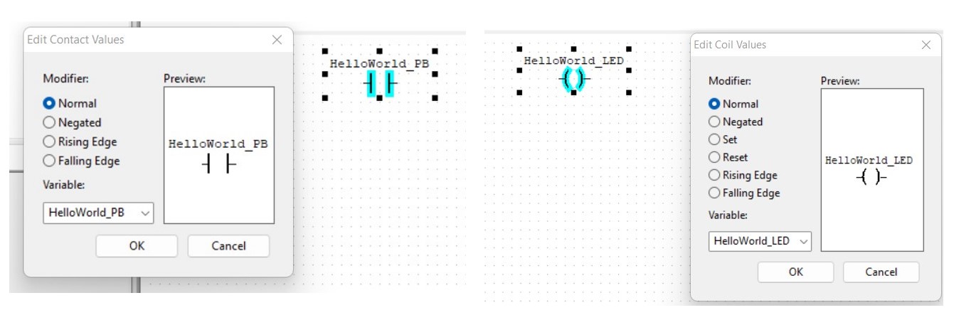

Select the XIC and OTE bit instructions and place them respectively on the left and right sides of the LD program build section of the OpenPLC editor. The tags you created will be associated by selecting the correct bit instructions. Figure 12 shows the tags associated with the correct bit instructions.
Placing and configuring the XIC and OTE bit instructions
Figure 12. Placing and configuring the XIC and OTE bit instructions.

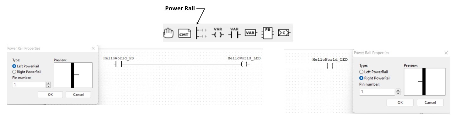

Select the power rail and configure the number of pins to connect the XIC and OTE bit instructions and build the single rung of logic. The pins are the rungs for the LD program. Figure 13 illustrates the selection and configuration process of the power rails.
selection and configuration of the power rails
Figure 13. Selection and configuration of the power rails.

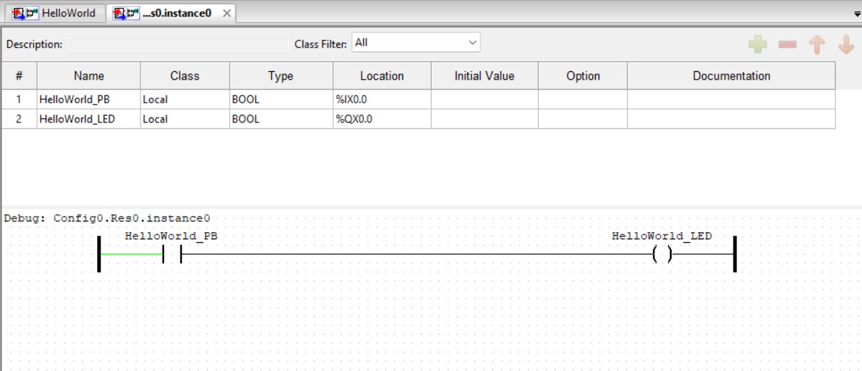

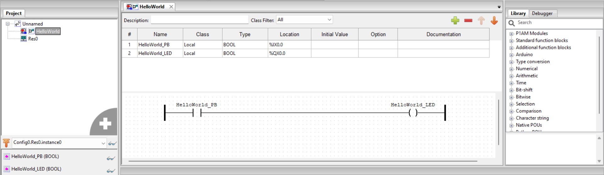

The final step of building the LD program is connecting the XIC and OTE bit instructions together. Select the right end of the HelloWorld_PB XIC bit and drag it to create a line. Continue dragging the line to connect to the left side of the HelloWorld_LED OTE bit. This line creates a rung to manage the XIC and OTE bit instructions control logic operation. The completed LD program is shown in Figure 14.
The Hello World LD program
Figure 14. The Hello World LD program.
Super job building the Hello World LD program!

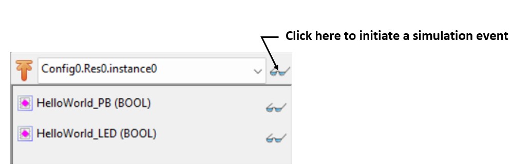

To run a simulation on the LD program, click the sunglasses next to the Config0.Res.instance0 dropdown box. You should see the left rung attached to the HelloWorld_PB XIC bit instruction turn green, indicating the LD program is ready to be simulated, as shown in Figure 16. Select the running man at the taskbar to run the LD program. The ‘PLC Started’ text will be displayed in the PLC log section of the editor.
starting an LD simulation event
Figure 15. Starting an LD simulation event.
Hello World LD is ready for simulation
Figure 16. Hello World LD is ready for simulation.
To interact with the simulation, right-click to select ‘Force True’ from the presented selection list. The Hello World_LED OTE bit should turn green. Right-click again to toggle the force false. You will notice the Hello World_LED OTE turning OFF or displayed as black.

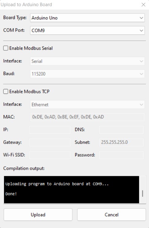

To upload, click the Arduino Uno icon in the taskbar to select the correct USB communication (COM) port and the appropriate microcontroller development platform. Figure 17 shows the configuration panel for the selected COM port and the Arduino board.
configuration panel
Figure 17. Configuration panel.
You may need to identify the correct COM port using your PLC development machine’s Device Manager. With the Arduino Uno board and the COM port selected, click the Upload button. After the runtime tool has converted the ST program to C-code then to a binary file and uploaded it to the Arduino, a ‘done’ message will be displayed in the compilation output window, visible at the bottom of Figure 17. Press the PB1 tactile switch on the solderless breadboard prototype, and the LED shall turn on. Releasing the tactile pushbutton switch will turn off the LED.
