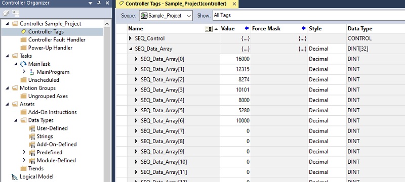

array data type in Rockwell's RSLogix (Studio) 5000 software
Figure 1. Creating an array data type in Rockwell’s RSLogix (Studio) 5000 software.
In Allen-Bradley’s RSLogix (which start with 0 instead of 1), our array would be written like this:
Recipe[0]
Recipe[1]
Recipe[199]

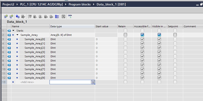

creating array data type as Data Block in Siemen's TIA Portal software
Figure 2. Creating an array data type as a Data Block in Siemen’s TIA Portal software.
Let’s say I make my own data type called “BoxInformation” and it has four integers and a string. If I made a 40 piece array of BoxInformation data, each one would have four integers and a string. Now what if I added an array of five integers inside my datatype? Each piece of data that was of that data type would now have four integers, a string, and an array of five Integers. If I made an array of these, each spot in the array would have another array inside of it.

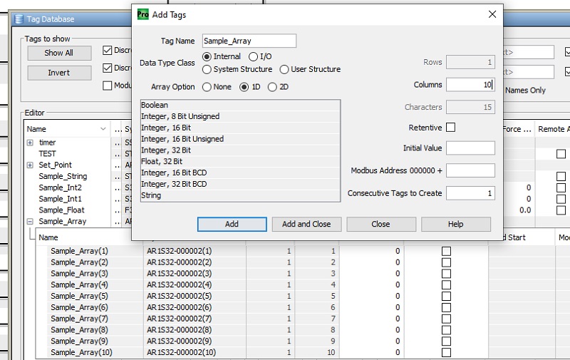

creating array data type in Automation Direct's Productivity Suite software
Figure 3. Creating an array data type in Automation Direct’s Productivity Suite software.
