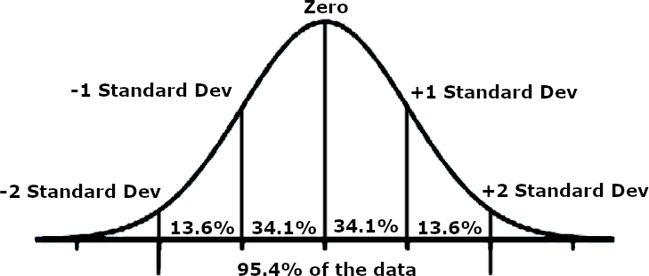

Your zero point is the middle, or mean, of the data in your array. If you go 1 ‘standard deviation’ up and 1 ‘standard deviation’ down, you will have 68.2% of your data. If you go 2 ‘standard deviations’ up and 2 ‘standard deviations’ down, you will encompass 95.4% of your data in this region.
The reason this is valuable is that it allows you to reject data points that are outliers and may be bad data. Let’s make an example. You are collecting data from an area that has terrible interference from another critical system. This interference causes the sensor to give faulty data every once in a while. For every 200 data points you collect during the day, 2 or 3 are way off. If you tried to make decisions with this garbage data, you’d end up having problems with your calibrations.

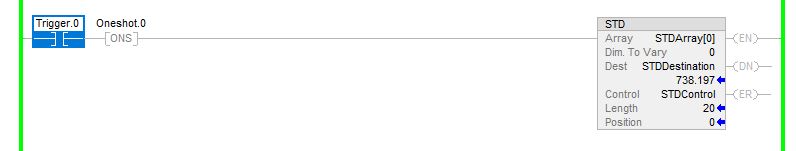

Let’s give a rundown of the tags used by this instruction. First, we’ve got the Array field. The Array is the data set that you are going to be using. It can be an array of any standard numeric tag and have up to 3 dimensions. The next field is the Dimension to Vary, which will be dictated by your array. If you are using a standard array, then you will use the 0 dimension. For a 2D or 3D array, or more, the dimension may be 0, 1, 2, etc… The next tag is the destination. This will be the REAL that the standard deviation is stored to once it is calculated. The next field is a normal Control tag, and after it is created, you can set the Length below it.
In the example I set up above, I calculate the standard deviation of STDArray starting at position 0 and continuing for a length of 20 elements. One standard deviation of this data set is 738.197, as is seen in the Dest position.
I can now use this standard deviation to create boundaries for my data.

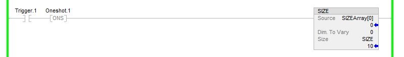

You can see, as usual, we have our source array. After that, we tell it what dimension to use. Finally, we have the Size data field where we put our resulting data. You can check all sorts of arrays, including string arrays. If you have a user-defined datatype, this instruction may become even more valuable, as hunting down individual arrays within data types can be tedious.
With this resulting size number, you can make actionable decisions to change how a PLC functions based on the size of the data it needs to use.
