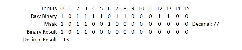

Now let’s look at a piece of data through a mask in Figure 3.
Integer of data from an input card with a mask
Figure 3. Integer of data from an input card with a mask.

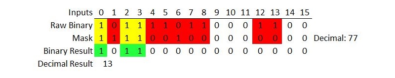

To make it a little more clear I’ve made the same set of data with color coding in Figure 4.
integer of data from an input card with a mask
Figure 4. Integer of data from an input card with a mask. Notice that ‘1’ and ‘1’ result in ‘0’, but both ‘0’ and ‘1’ and ‘1’ and ‘0’ result in ‘0’.
If we had to measure the length of something with inputs 0, 2, and 3, we can pick and choose the bits we need with a mask. The mask is entered as a decimal number, so you will have to calculate the binary to decimal values. To do this, I always create an INT in the program and manually toggle the bits for my mask and then copy the resulting number in the tag monitor to ensure I get my value right.

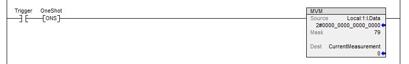

The way we set up the instruction for use in the logic is similar to the standard MOV—we just need to add the mask in the middle.
MVM is similar to MOV but includes 'Mask' in between 'Source' and 'Dest'
Figure 5. MVM is set up similar to MOV but includes ‘Mask’ in between ‘Source’ and ‘Dest.’

    LivB99 September 25, 2023
    I am getting the decimal value for Figure 2 as 48524. Can you explain the steps you took to get 12733? Thank you
    Like. Reply
    • D
      David Peterson September 25, 2023
      It looks like the way he wrote the binary number is with the lowest bit on the left, not on the right like it appears in most PLC environments. I just made an INT and filled it with those bits, starting with .0 on the left and going to .15 on the right, and the value does come out to 12733. If you fill the INT in right to left order, it's the 48524 that you got in your test.
