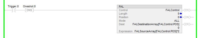

The next piece of information is the Destination. The destination tag needs to be an array that has enough spaces for the source array that we will put in later. Below, in the logic snapshot, I have 5 array positions so I used a Length of 5, a Destination array with 5 DINTs, and a source array with 5 DINTs. That way everything has a matching size and there are no conflicts. Note that the Pointer of the array in my logic is actually a function of the FALControl.POS —the position of wherever the instruction is currently performing a function. If you plug a static number in here, it will overwrite every number and won’t work. You have to have the variable array pointer that is tied to this specific instruction.
FAL Expression Tag
Finally, we have our Expression. Our expression must contain the array we want to manipulate and the math function we will be using on it. It is important here, again, that you use the Position of the Control tag so that you perform each function on the correct number as it goes through the array.
For a list of available operators in these math instructions, you’ll need to consult the Help portion and ensure your controller is capable of all the math functions you need. This will feel quite similar to most operations available in the compute (CPT) functions. The syntax of the operations follow generally accepted syntax, multiply *, divide /, add +, and so on.
Let’s examine the instruction in the logic below:
File Arithmetic and Logic (FAL) instruction syntax in ladder rung
Figure 1. Example of File Arithmetic and Logic (FAL) instruction syntax in a ladder rung. Author’s image

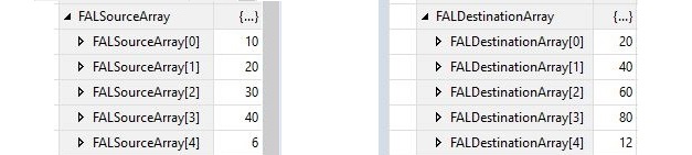

When I hit the trigger, let’s look at what happens between the source array and the destination array. As you can see in my logic, I multiply every source array position by 2 and then drop the result into the matching array position in the destination array. Works like a charm!
FALSourceArray on left side, and after dividing by 2, destination array on right
Figure 2. Following along with the previous example, the FALSourceArray on the left side, and, after dividing by 2, the destination array on the right. Author’s image

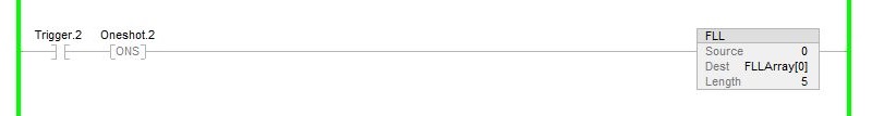

Ready for something a little simpler? We can do that with the FLL instruction. If you drop an FLL into your logic, you’ll notice that, while it manipulates arrays, it does not have a control bit. The goal of the FLL is not to perform a function on each individual element of the array, but rather to load a single value into EVERY element of the array.
FLL Source Tag
First, you need a piece of source data. I am going to use a static 0 value, but you could use a DINT tag or even a float. If you do use a variable tag, remember that it needs to match up with the data type of the array so that you don’t end up losing data. If you try to move a REAL into a DINT, you’ll drop off the decimal places and end up with incorrect values.
FLL Destination (Dest) Tag
The second thing you will need is an array to fill. You’ll plug this array into the Dest position in the instruction with the starting element. I am starting with position 0 as you can see below in the brackets.
FLL Length Tag
The last thing you need to do is tell the FLL instruction how long the array is that you need to be filled. My array is 5 elements long, so I am going to plug in the number 5.
Here’s what it looks like in live logic.
File Fill (FLL) instruction syntax in a ladder rung
Figure 3. Example of File Fill (FLL) instruction syntax in a ladder rung. Author’s image

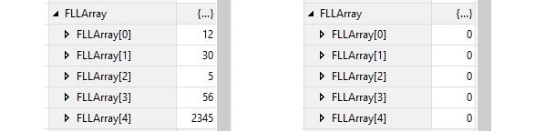

Let’s look at what happens when we hit Trigger.2 and activate this instruction. On the left is the array when we started. I hit Trigger.2 and it filled the array with the source number. On the right is the resulting array. It’s filled with zeros and ready to go!
FLLArray on left side filled with 0
Figure 4. Again following along with the previous ladder example, the FLLArray on the left side has now been filled with 0, just as the FLL instruction in the logic directed. Author’s image
