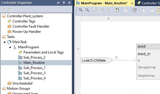

Within a PLC program, you can have multiple FBD routines that are called in parallel or in series, this allows you to make smaller routines that break up your code and process. Reviewing or trying to understand someone's code can be difficult, especially if there are many different processes happening at the same time.
I like to use the “less is more” technique when I’m structuring my code. I’ll break the process down into smaller sub-processes that may utilize five to ten function blocks, and each sub-process will only contain one unique task. The exception to this rule is if one sub-process is very small, I might group it with other small processes.
Sometimes, this style is simply not achievable because the overall process is small or the controller doesn’t allow for multiple subroutines. In this case, I’ll use comments and spaces between the processes to clearly define the different processes.
FBD structure and subroutines
Figure 2. Organization of FBD subroutines within the Studio 5000 environment.

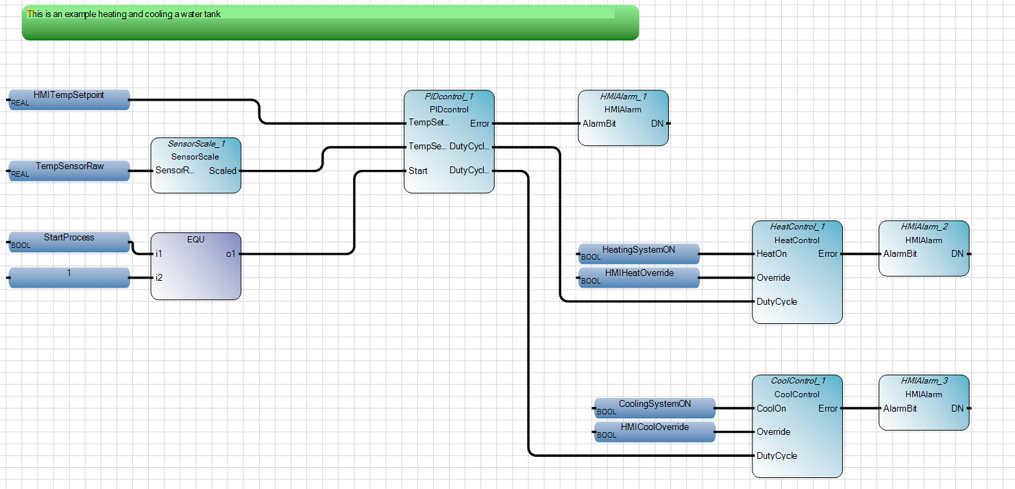

FBD program in CCW
Figure 3. Function block diagram example. Author’s image, created with Connected Components Work Bench (CCW)

An FBD can really be used in just about any scenario but they work best when working with processes that rely on timed events or analog sensors. A common use is temperature control. When controlling the temperature of a water tank, you might have a heating cycle, a cooling cycle, a PID, and analog conversion. These function function can all be their own function block with the diagram connecting them together.

The best place to use an FBD is at the highest level of the process. Think of the FBD as a conductor of an orchestra. The FBD commands and feeds information to all the other smaller processes, but the FBD still has only one main process.
In our water tank example, the purpose of the main process is to maintain the temperature of the water for one tank. If I had multiple tanks, I would create another FBD that would bring together all the water tanks’ temperature control. Combining processes this way allows for easy-to-read and understand function block diagrams.
