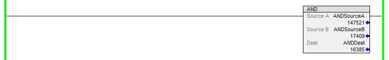

Sometimes, the default view presents the instruction in a way that can be more difficult way to visualize. In Figure 1, you’ll see the result of an AND function if you were to just drop it into a program.
dropping AND function into program result
Figure 1. Result of dropping AND function into a program.

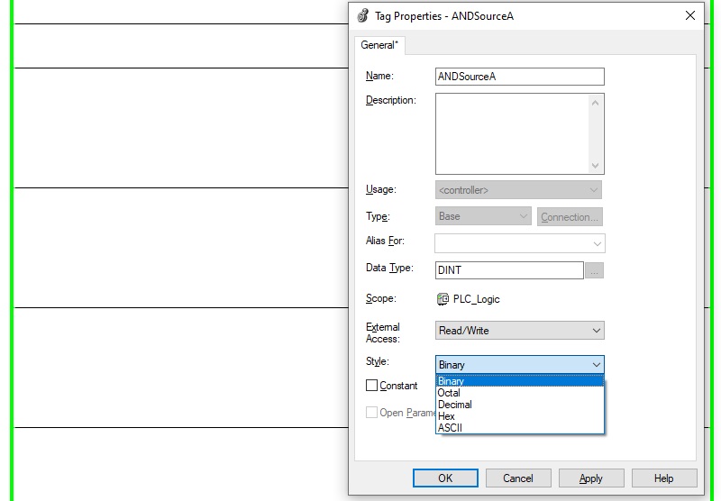

If someone asked me to describe what was going on in that instruction, I’d tell them, “Something… math-ish…” Trying to understand these instructions while in decimal mode is going to be terribly difficult. Fortunately, we can change this. Let’s go into our Tag Properties and change the Tag Style for these tags we’re using (refer to Figure 2). Switching these to Binary will help us out a lot.
switching Tag Style to Binary rather than decimal
Figure 2. By switching Tag Style to Binary, we’ll be better able to see the entire instruction.

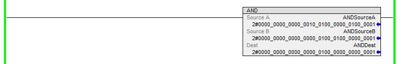

Now that we can see the entire instruction in Figure 3, we can more easily determine what is happening here. The operation is something that an integer programming language would refer to as a ‘bitwise AND’ function.
Each bit in the Source A data is compaired with the matching bit in Source B to create an AND function. The AND’ed result of each pair is then placed in the Destination tag. In the logic we created above, you can see we essentially created 32 AND gates because we used 2 DINTs (Double Integers).

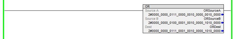

In the AND instruction, we were able to turn an output bit on if both inputs were true. In the OR instruction, we turn the output on if either input is true. If the first bit of only Source A is on, the output turns on. If the first bit of only Source B is on, the output turns on. Lastly, if the first bit of both Source A and Source B are on, the output turns on. You can see in Figure 4 in the live program snapshot how the different combinations work.
different combinations in the OR instruction
Figure 4. A look at the different combinations in the OR instruction.

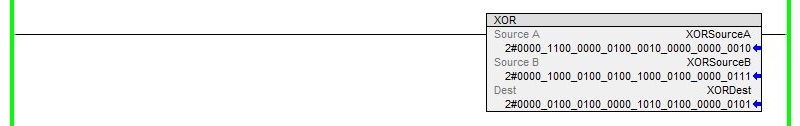

The XOR (Exclusive OR) instruction differs slightly from the OR in this way:
  • If both Sources A and B are off, the output goes false.
  • If Source A is on and Source B is off, the output goes true.
  • If Source A is off and Source B is on, the output goes true.
  • If Source A is on and Source B is on, the output goes FALSE.
The critical difference is that last one. In an XOR gate, it must be one or the other, not both together.
Depending on the inputs given, the instructions executes the XOR function and dumps the result into the Destination tag, as seen in Figure 5.
XOR function result in Destination tag
Figure 5. XOR function result in the Destination tag.

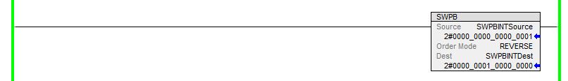

If you’re moving an INT (Integer), there are only 16 bits and the SWPB instruction gives you only one option no matter what you pick. The 8 bits left of center are swapped with the 8 bits to the right of center.
This expression would be demonstrated in letter form below:
AB => BA
Now let’s look at it in logical form in Figure 7. Remember this is for INTs, no matter what you pick for an Order Mode, it will always do the same thing.
moving an INT gives the same output, regardless of Order Mode
Figure 7. When moving an INT, it will give the same output, regardless of Order Mode.

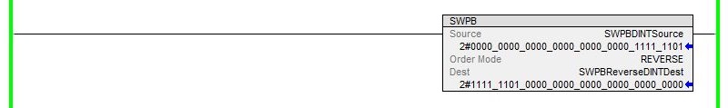

Now let’s move on to DINTs. There are three different ways for you to be able to shift bits around in these. If you recall above, a standard layout for a DINT is ABCD. If we choose the REVERSE option, we would take the ABCD and rearrange the bits to form DCBA. This is shown in Figure 8. Our data in Section A of the Source is moved to Section B. The other sections would follow suit according to the Order Mode letter layout.
Data from Section A of the Source is moved to Section B
Figure 8. Data from Section A of the Source is moved to Section B.

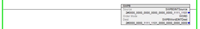

Now for the WORD Order Mode, ABCD becomes CDAB. This is because a WORD is considered as 16 bits, so AB constitutes the first 16 bits, and this is swapped with CD, which is the second set of 16 bits.
In the logic in Figure 9, you can see our 8 bits in position D started on the right and ended up becoming placed in the second position from the left. All other data will be moved according to the WORD Order Mode.
8 bits move to second position from left
Figure 9. The 8 bits are placed in the second position from the left.

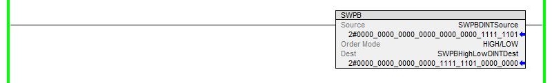

The last type of move that we deal with in the SWPB instruction is the HIGH/LOW. In this one, we start with ABCD and end up with BADC. Instead of flipping the whole thing around, this time we just reverse the order of A and B then reverse the order of C and D. You can see in the logic in Figure 10 how our Data in position D has simply swapped over one spot to the third position. All other data would move according to the HIGH/LOW Order Mode letter layout.
Data in position D swapped to the third position
Figure 10. Data in position D swapped to the third position.

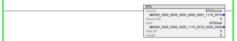

Alright, I hope your brain isn’t too confused yet! We’re now on the last instruction in this article. The BTD function. This function can take any number of consecutive bits from a Source integer and place them into an arbitrary spot in a Destination integer.
We identify a Source DINT or INT and a starting point. In my logic, I used bit position 0 as my start point. We then give it a destination DINT or INT to place our data into as well a Destination Bit to serve as a starting point for where we are dropping in the data. Lastly, we give it the length—the number of bits to transfer starting from the source bit position.
In Figure 11, we can see I told my PLC to take 8 bits, starting in the BTDSource DINT Position 0, and drop them into the BTDDest DINT, starting at position 8. It executed exactly as we told it to. You can customize this to fit whatever needs you have.
8 bits moved from position 0 to position 8 using the BTD instruction
Figure 11. 8 bits moved from position 0 to position 8 using the BTD instruction.
