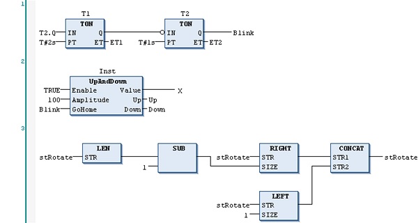

An FBD (function block diagram) program is a graphical programming language that joins functions together to produce an output. Using lines and flags to represent variables in a more graphical format, the user can quickly build a program by dragging, dropping, and connecting different function blocks and variables.
In the end, the program looks similar to logical block diagrams that might have been used to describe complex processes in school or during the design phase of equipment. By using a graphical programming language, the user can quickly produce programs using proven, debugged, code which reduces integration time and results in less wasted product. Users do not need an extensive programming or electrical background to develop FBD programs.
Figure 1. An example of a function block diagram program. I
Figure 1. An example of a function block diagram program. Image used courtesy of Schneider Electric

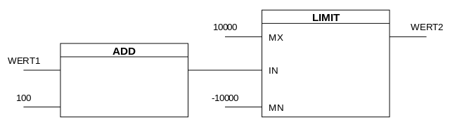

Figure 2. Function blocks, although not strictly ladder logic, look familiar to ladder users as they accomplish some ladder tasks.
Figure 2. Function blocks, although not strictly ladder logic, look familiar to ladder users as they accomplish some ladder tasks. Image courtesy of Wikipedia

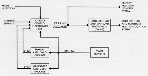

Figure 4. A practical example of function blocks that represent a process, not exactly a program.
Figure 4. A practical example of function blocks that represent a process, not exactly a program. Image used courtesy of Wikipedia
