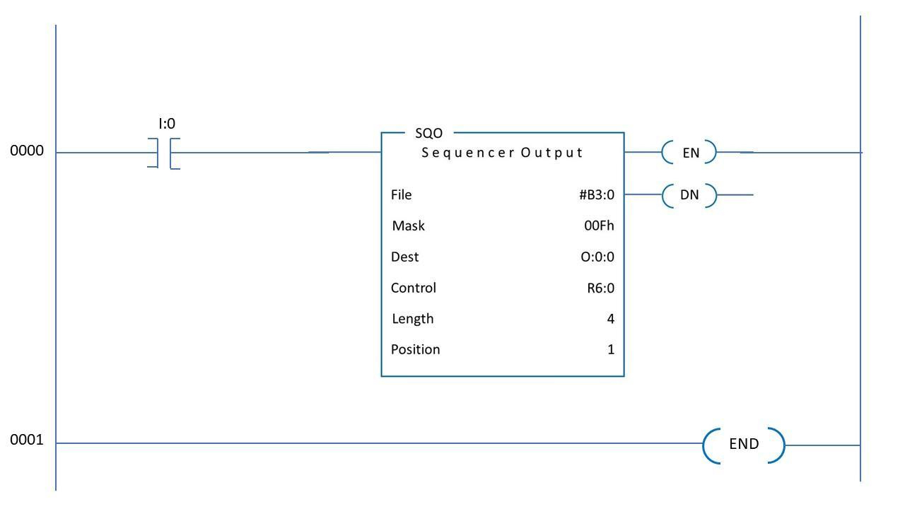

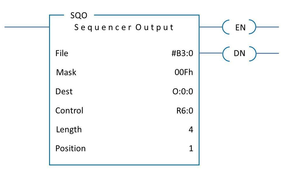

After the four steps are completed, step one is executed, and it goes on. This can be achieved with sequence output instruction (SQO) using a PLC. SQO instruction transfers a 16-bit data to control outputs for sequential machine operations. The symbol for the sequencer output command is as shown below.
SQO representative symbol.
There are six parameters represented in the symbol.
File: This represents the memory address of the sequencer file. We must create a file with Boolean bits representing the various steps in the sequential output.
Mask: It represents the address in which the sequence instructions are given. In the example symbol given we have given 00F in hexadecimal. The first eight bits do not provide any data and the complete data is in the last four bits.
Dest: This is the address of the output file to which data is transferred from the sequencer file.
Control: This shows the address of the control element that stores status byte., length, and position of the file.
Length: This indicates the number of steps in a sequence. Since we have four steps it is shown as 4 in the symbol.
Position: This represents the exact step that is being executed at the moment.

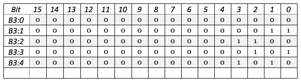

We also must give the input for the sequencer in the file B3. For example, considering the lights we have, 4 steps, and the file would look like this.
B3:0 represents the starting position of the setup. B3:1 represents the first step and so on. Bit 0 is for the status of L1, Bit 1 for L2, Bit 2 for L3, and Bit 4 for L4. The high value of the bit (1) indicates light being bright, and low value (0) indicates the light turned off. We have mapped the required Boolean values in each step to the sequencer file. The ladder diagram for the setup will be as shown below.
Ladder diagram for the example setup.
The four outputs corresponding to bit 0, bit 1, bit 2, and bit 3 is connected to L1, L2, L3, and L4 respectively. In the initial position, the values in B3:0 will be replicated, and all the lights will be turned off. When the first pulse is applied to I0, B3:1 will be replicated. L1 and L2 corresponding to bit 0 and bit 1 will be turned on.
Similarly, in the next pulse, L3 and L4 will be turned on and L1 and L2 will be turned off. In the next pulse, L4 will be turned off and L3 and L1 will be bright. In the same fashion step, 4 is replicated at the next pulse of I0. After that step 1 will be replicated again.
