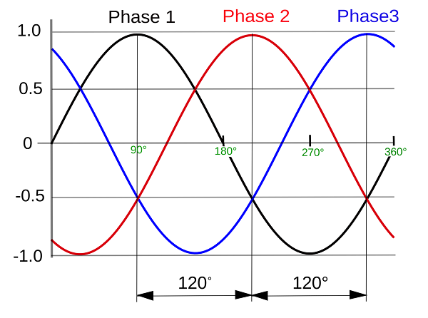

Three phase power can have either four or five wires, depending on the configuration. There are three phase lines, sometimes a neutral line and almost always a ground line (the ground line is often not mounted as one of the wires, so this may be reported as “3-wire…” or “4-wire with ground”). The three phase lines each act as hot wires, but they are placed 120 degrees out of phase from each other.
3-phase electricity sequence
Figure 1. Three phase power sequence diagram. Image used courtesy of Wikipedia Commons

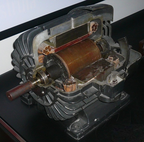

Motor cutaway view
Figure 2. A cutaway view of a three phase motor. Image used courtesy of Wikipedia Commons
