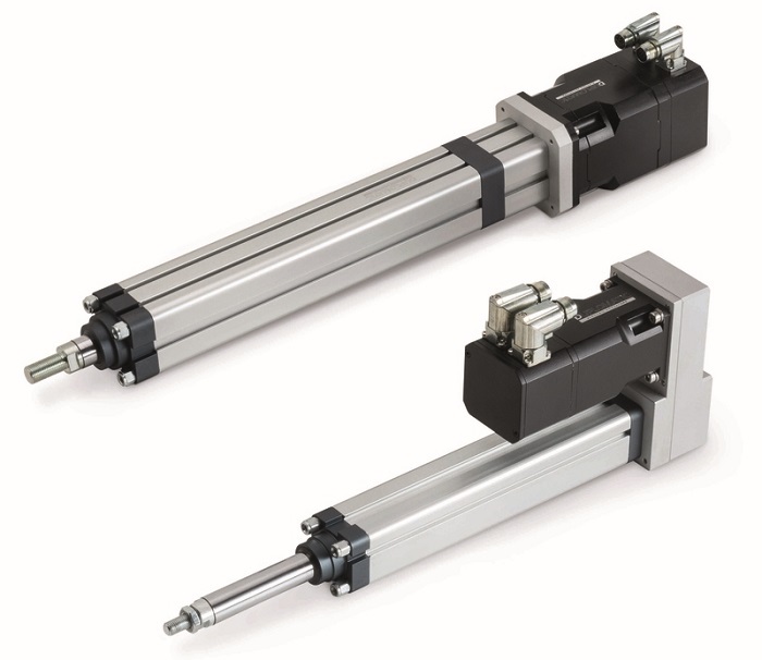

Selection of electric actuators
Figure 1. Two standard electrically driven linear actuators. Image used courtesy of Continental Hydraulics

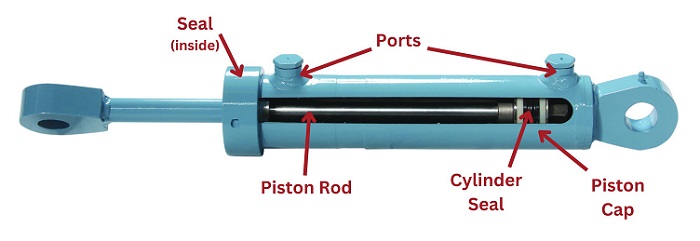

Understanding Hydraulically-Driven Linear Actuators
Hydraulic actuators are devices designed to convert hydraulic pressure into mechanical motion. The key components of a hydraulic actuator include a piston, cylinder, the ports. Here's a breakdown of each of these components.
Piston
The piston and piston rod are sealed to the inside of the cylinder, with fluid pushing on the piston to extend and retract its direction of motion.
Cylinder
The fully sealed outer housing of the actuator provides both protection for the fluid and seals inside, but also a strong seal against the high-pressure fluid, and many options for mounting the cylinder to its machine application.
Ports
The inlet and outlet ports allow the fluid to enter to extend or retract the cylinder. If fluid enters one port, it must be allowed to vent out the other port. In a pneumatic cylinder (mentioned next), one of the ports may be vented to the open air and a spring returns it to a normal position. These are called single-acting cylinders.
Internal components of a hydraulic cylinder
Figure 3. Typical components of a hydraulically driven linear actuator. Image provided by the Control Automation engineering team
