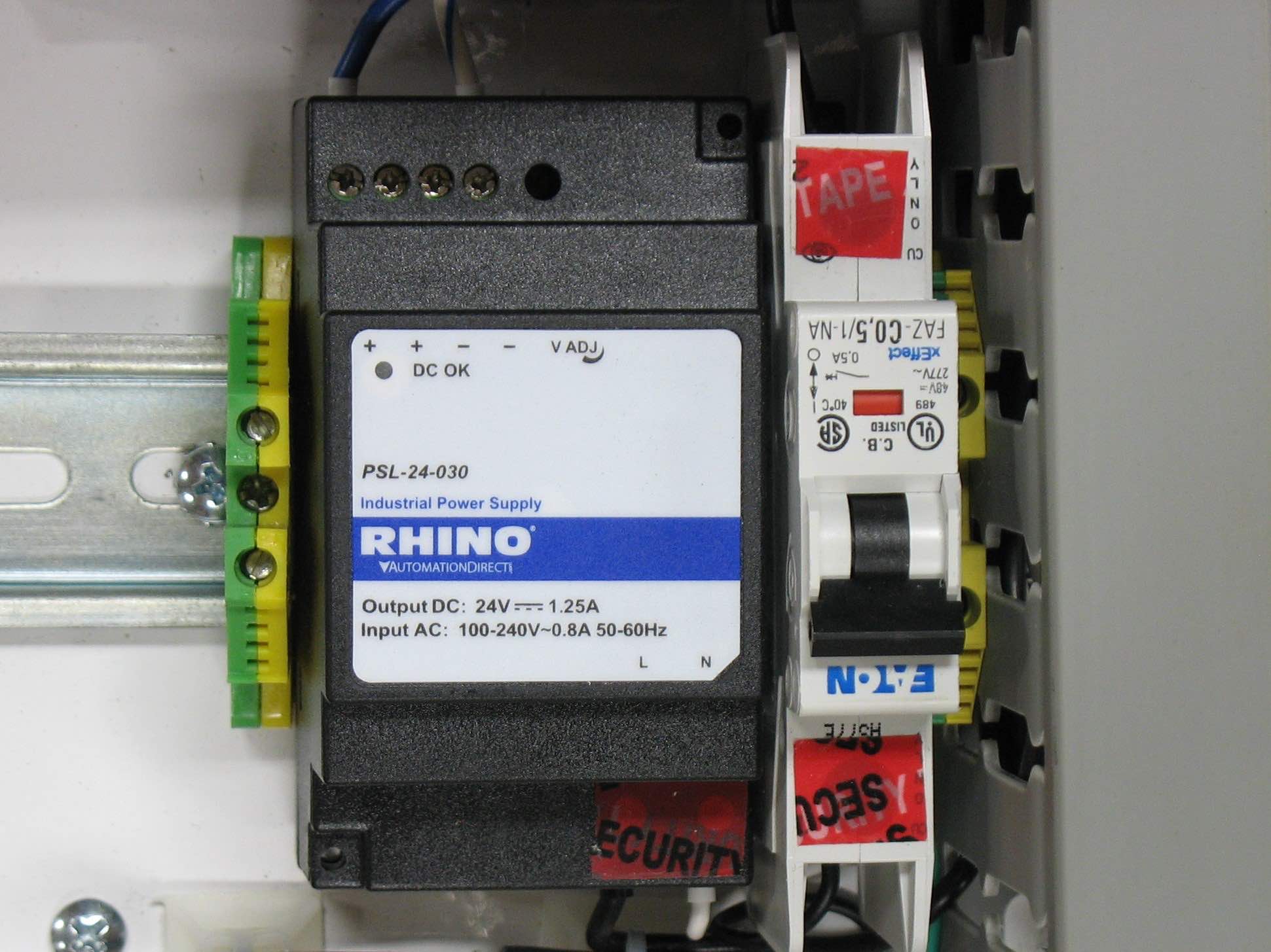

Most industrial power supplies use 1- or 3-phase input power. They also often have a voltage adjustment screw terminal, indicated here with 'V ADJ' with the curved arrow.
On the other hand, the output is the main factor determining whether the devices will be receiving proper power. Testing the output terminals should yield something very close to the rated output voltage.
Industrial power supplies can sometimes be adjusted within a small range to fine-tune the output, but this is designed to compensate for loading effects.
It would help if you planned to adjust this at the very beginning of the installation. It should not increase the voltage if it should suddenly drop one day after years in service.

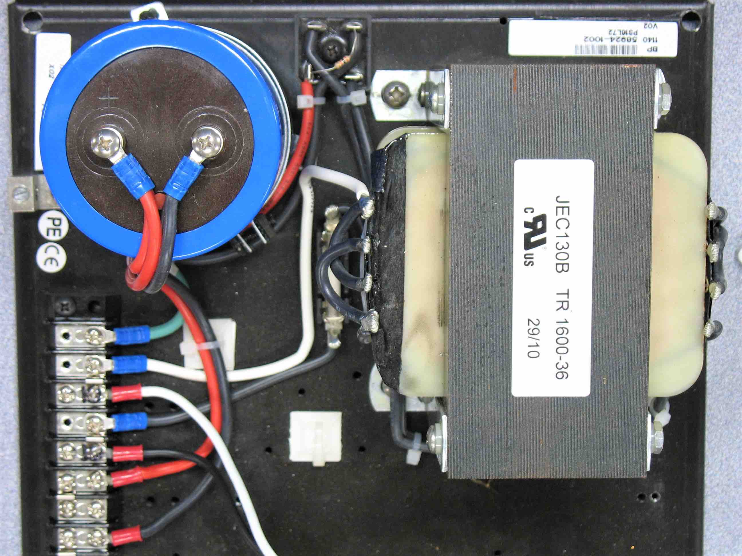

First, a transformer (usually a large one) will have an input primary coil side with the supply AC voltage across it. Often there is a fuse in-line or even built into the transformer. This may be the overloaded component. The secondary coil voltage should be stated somewhere on the datasheet or the part sticker and measured as AC voltage.
Second, a bridge rectifier consists of two diodes always in series with each other at any time. The following components, such as the capacitor, will now show DC voltage. Be careful when testing capacitors as they can often store a dangerous charge, but the high impedance of a voltmeter creates a safe test for these relatively low voltage supplies.
You can only correctly measure the section between the rectifier and the regulator with an oscilloscope.
This linear power supply has a fuse (center) in-line with the transformer on the right side, clearly visible primary and secondary terminals, the bridge rectifier at the top, and a capacitor on the left.
This supply type would be quite expensive, and the ease of component replacement might make a favorable repair.
