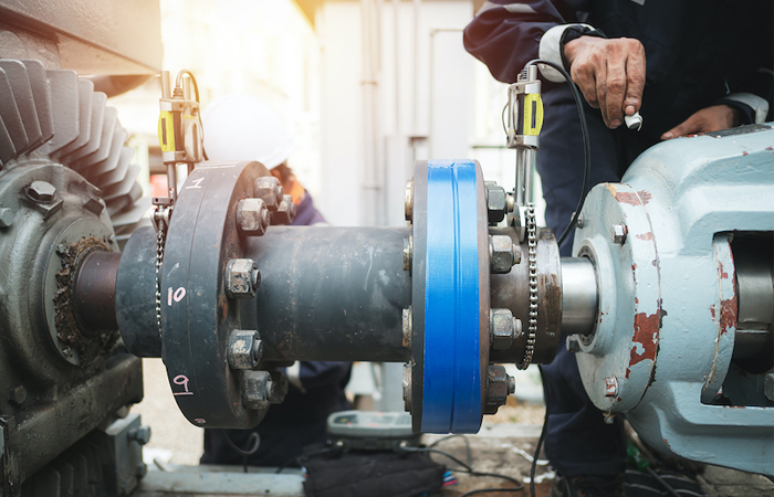

Vibration Analysis
Vibration analysis is used for rotating/moving mechanical parts. Normally any rotating or moving part creates vibration, but any change in the levels of vibration is not a good thing. This maintenance technique can be used to indicate problems with the bearing, misalignment between rotating components, or issues with the shaft in a rotating mechanism.

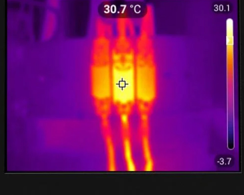

Temperature Measurement of Electrical Panels
Temperature measurements of electrical panels can be performed to detect the uneven distribution of load, improper connections, or under or overrated installed components. All these are represented by the uneven distribution of temperature value displayed on the device. More commonly, this test is performed using thermal imagers. The major advantage of temperature measurements is they can be performed without dismantling the electrical panel.
Figure 2. Thermal imaging of an electrical component. Image courtesy of Fluke Corporation.

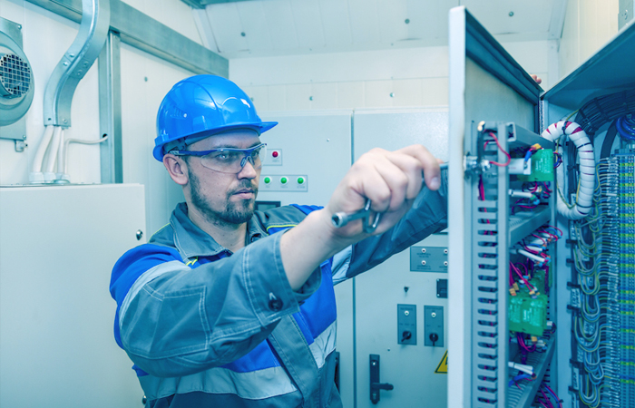

Electrical Panels
In an electrical panel, the state of the electrical components are checked. This includes tightening of screws, checking the panel fan, removing dirt, and moisture cleaning.
Electrical panels must be maintained on a regular schedule.
Special attention should be paid to power incoming and earth connections.
