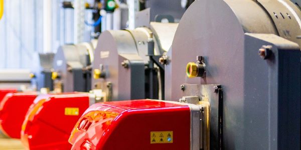

The reliance industrial manufacturing has on well-maintained boiler systems is critical. Most obviously, boiler systems provide heating requirements. However, there are also manufacturing activities dependent on what the boiler produces — steam and heat — for safe production, such as in the pharmaceutical and food and beverage industries.
Figure 1. Boiler systems are a critical part of many manufacturing processes. Keeping them well-maintained is crucial.

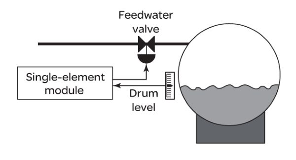

Drum Level Measurements
The drum is the boiler’s fundamental section where conversion from water to steam takes place. Drum measurements include measuring for the correct levels of steam and water.
Figure 2. Single element drum level control. Image courtesy of Schneider Electric
Level measurement is essential because the drum’s performance and longevity are affected by the uneven portion of the steam and water levels. If the water level is too low, then heat (high temperature) damages the internal structure of the boiler. If the water level is higher than the normal range, the excess water flows through the output, again damaging the respective parts.
Common methods of measuring include utilizing a differential pressure transmitter. Some manufacturers also use guided wave radar technology for better performance.

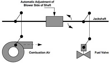

There are two methods of implementing a combustion control system: single point positioning and parallel positioning.
Figure 3. Diagram of single point positioning Image courtesy of Yokogawa
Single point positioning, also called the jackshaft control method, includes mechanical linkage to control the fuel control valve and airflow damper to the burner. Parallel positioning uses a master pressure controller to control the fuel control valve and airflow damper.
