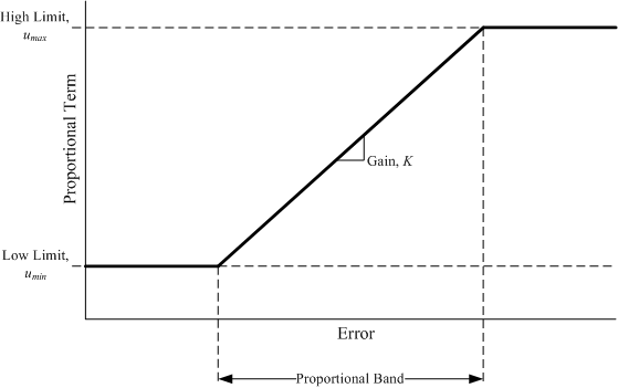

proportional gain and proportional band in proportional control straight line equation
Figure 2. Proportional Gain and Band in the straight line equation of Proportional Control. Image used courtesy of Johnson Controls
Proportional band is another very important concept. The proportional band tells us the total range of the controlled output that can be produced within the controller’s 0% and 100% limits.
The graph above shows the same straight-line equation of proportional output or term (\(P_{out}\)) versus error. Remember that the error is simply the difference between the set point and the present values. The gain (\(K_p\)) is also shown as the slope of the straight line.
All process controllers have upper (\(u_{max}\)) and lower (\(u_{min}\)) range limits. In the transmission standard discussed before, is \(u_{min}\) = 4 mA and \(u_{max}\) = 20 mA. So, the proportional band tells us how much we can affect our controlled variable within the operating range of our controller. It is also known as the throttling range.
The proportional band has an inverse relation to the gain, thus, the formula to calculate it is simple:
$$PB=\frac{1}{K_p}$$
The PB is also expressed as a percentage. In our previous example, the gain of the process was 3; then, the proportional band would be 1/3 or 33.33% of the controlled output.
