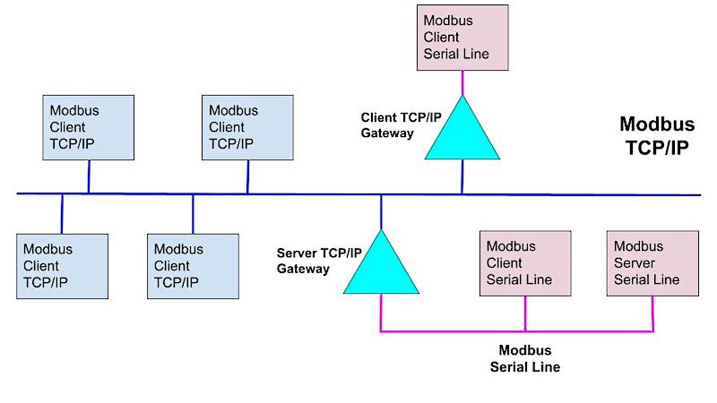

Modbus
Modbus is an open remote communication protocol created by Modicon, now Schneider Electric. Modbus is one of the most common protocols and connects electronic devices. Electronic and instrumentation systems such as PLCs, HMIs, and VFDs use the Modbus, where the central controller is responsible for collecting necessary data from the field devices.
Modbus client/server
Figure 3. Modbus client/server flowchart.
Modbus uses both serial and Ethernet lines to network with other devices. The serial version is Modbus RTU and Modbus ASCII, while the Ethernet version is called Modbus TCP.
Modbus works according to the client/server (formerly "master/slave") network system. It means that there must be at least one client device in the network, and all others are servers. The server devices are dependent on the instructions from the Client device to read data from the server and similarly write data to the server.
The Modbus protocol is commonly used to monitor building management systems and equipment or machines using automation systems, such as production machines in a manufacturing industry.
