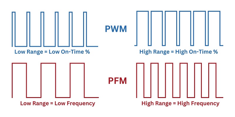

PWM compared to PFM
Figure 1. PFM as compared to PWM for low-range and high-range signals. Note that the PWM at the top is a fixed frequency, varying width %, and the PFM at the bottom is a fixed width %, but varying frequency. Image used courtesy of Control Automation
How is PFM Different from PWM?
The main difference between PWM and PFM is that PWM, since the width of the pulse is changing at a fixed frequency, a timer must be reserved for measuring the duration of the ‘on’ time of the pulse, thus yielding a ‘duty cycle’ percentage, equivalent to 0-100% of the full voltage analog signal. Since the frequency of the signal does not change, only the duration of the ‘on’ time, we have no need to count the number of cycles in a second as it is fixed.
In contrast, the PFM concept varies the frequency of the signal, but each of the pulses maintains an equal time off and on. This equal on/off pulse is known as a square wave pulse, so we have no need to measure the duration of each pulse. There are two ways to measure a PFM signal, which provides some diversity to the use cases and control theories.
Measuring Overall Pulse Width
First, a timer can be used to measure the total duration of the pulse, then using the inverse of that pulse time to calculate the frequency, in typical electronic math fashion.
Measuring Pulse Counts Over a Fixed Time
If using a timer to measure each pulse is not practical or not possible, a counter can be used to measure the rising time or falling time, summing up the number of pulses over a short time to provide a snapshot of the current frequency.
Both of these strategies–pulse time and pulse count–depend on a known min and max frequency that relate to 0% and 100% of the full-scale real-world value. The max frequency must not be higher than the hardware counter is capable of detecting.

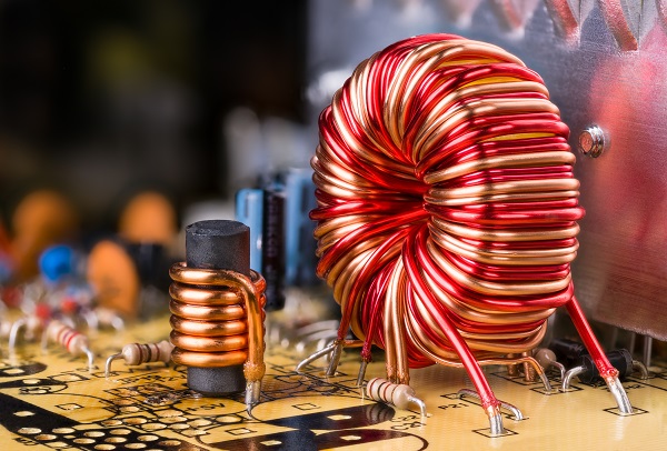

Toroid and ferrite core inductors on a PCB
Figure 2. When toroid and ferrite core inductors are used with a very low PWM duty cycle for light loads, they can reduce the efficiency of the supply, capitalizing instead on PFM pulsing. Image used courtesy of Adobe Stock
Power Supplies
First, switch-mode power supplies rely on a pulsing DC output, varying the power output to the load based on the load conditions. This allows heavy loads to receive a more constant energy supply as needed, but lighter loads can consume less power from the source, resulting in a more efficient supply.
However, when the typical PWM is supplied to a light load, the ‘off’ time of the pulse is very long, so the inductor supplying power is able to fully discharge and the supply capacitor can also discharge, reducing efficiency since it must be recharged before supplying power to the load. To prevent this problem, the PFM model uses a square wave with equal on/off times, so the inductor is never able to discharge and the supply of current is continuous.
