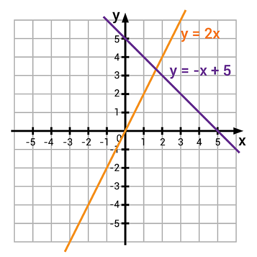

Figure 1. Slope intercept form of linear equations with plotted lines. Image used courtesy of Adobe Stock
