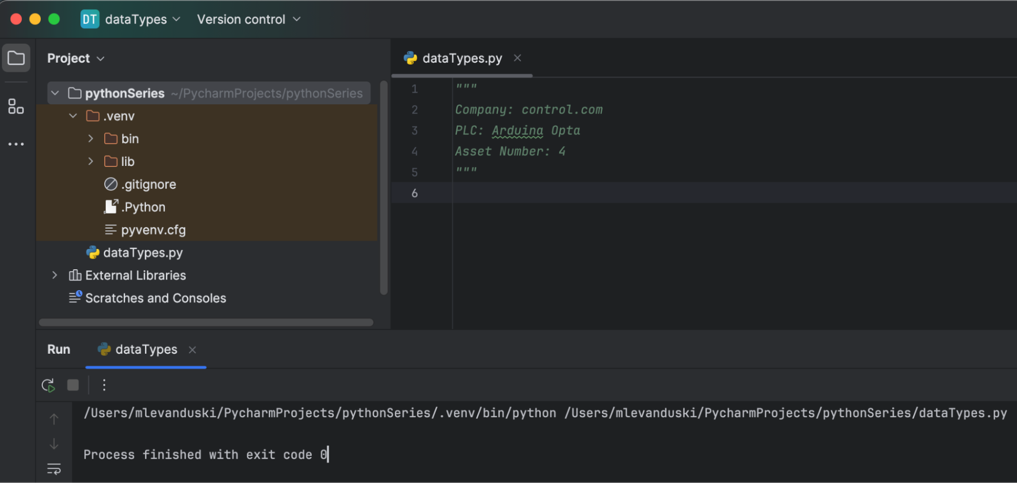

These are relatively simple strings, and in some cases you may find yourself needing multiple lines of text within a string. This can be accomplished by using triple quotes:
If you execute any of the above strings, you’ll notice the program doesn’t accomplish much aside from indicating the program executed with no errors:
Multi-line strings in Python
Figure 2. Execution of a multi-line string. Image used courtesy of the author

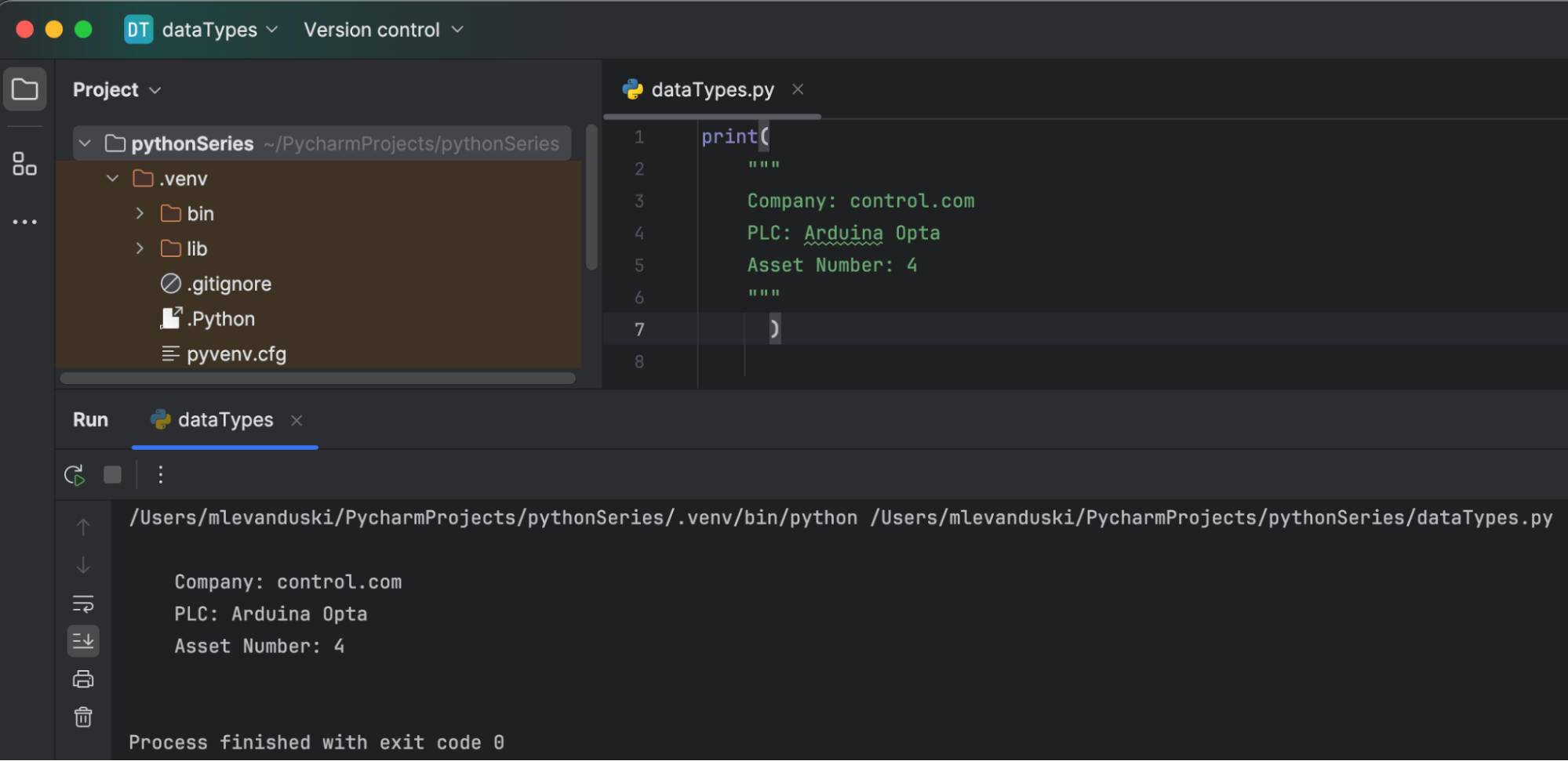

The print() Function and Variables in Python

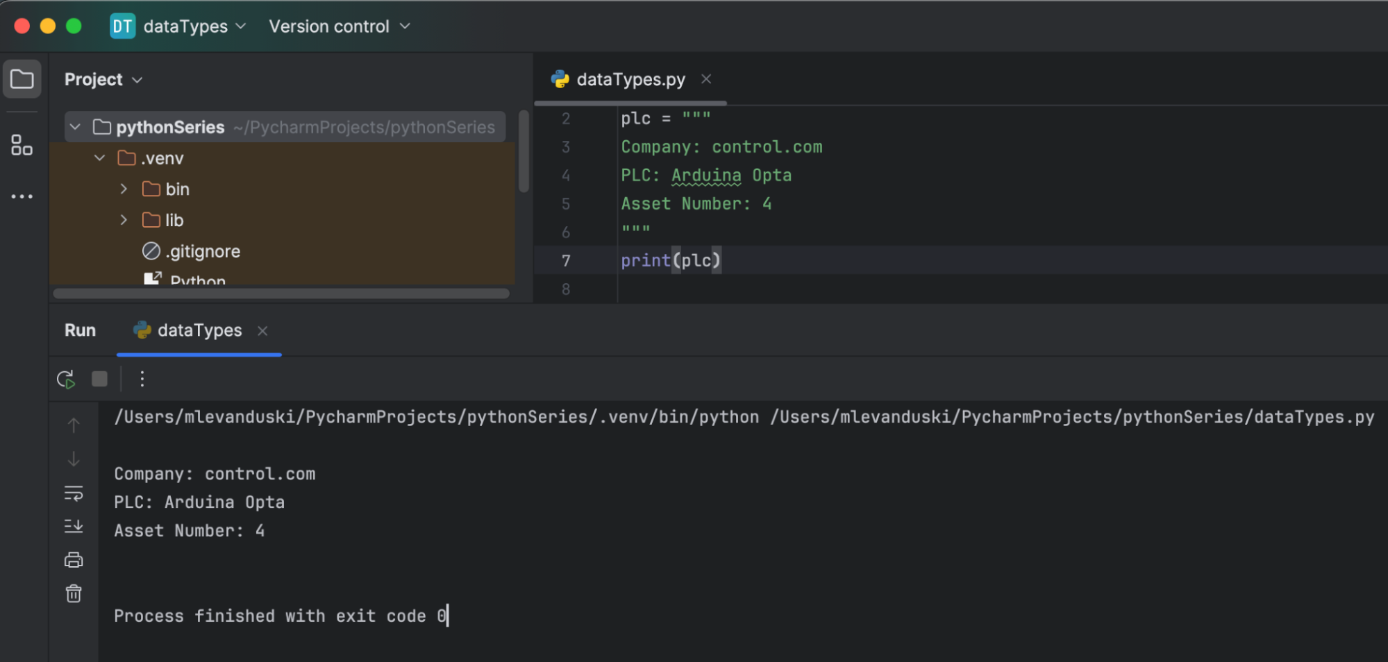

In order to see or log the previous multiline string to the terminal, we must use Python’s print() function. Functions are objects as well, but they behave similarly to an algebraic function such as y = f(x). The function takes an input x, does something with x, and then returns a value y. The print function takes an object supplied to it, such as our multiline string, and logs that string to the console as such:
print function in Python
Figure 3. Using the print() function to output a multi-line string. Image used courtesy of the author
You’ll notice that, in Figure 3, the multi-line string format within the parenthesis of the print function is somewhat difficult to type out manually. Furthermore, what if we wanted to reference this string again later in the code? Wouldn’t that be a lot of work to type all those characters again? This is where variables come into play. Variables can be assigned to represent an object. For example, let’s assign our multi-line string to a variable called “plc” and print the plc variable:
Assigning variables in Python
Figure 4. Assigning variables. Image used courtesy of the author

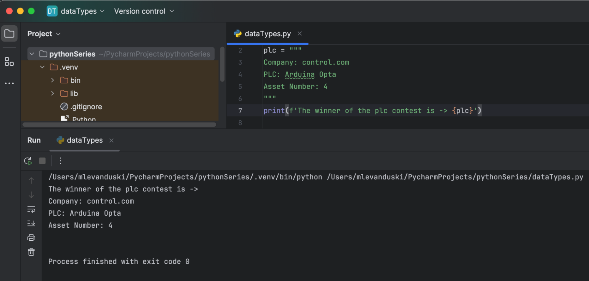

The name may sound funny, but now that you know about variables, a very handy tool for working with strings and variables are f strings. Let’s say you want to print a variable's assigned value within a string to log a message. We can accomplish this by wrapping our variable in curly brackets and prefixing the string with the letter f:
f String using variables
Figure 5. The usage of an f string to display a variable nested inside of a string. Image used courtesy of the author

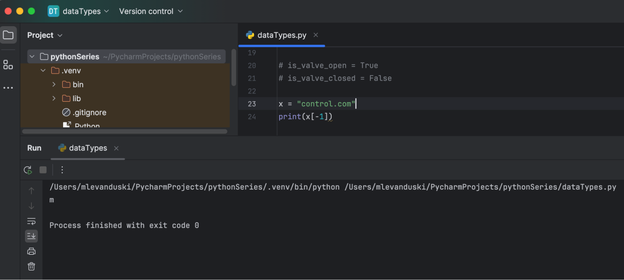

The indexing generally moves from left to right of the string with positive indices. However, it’s also possible to move from right to left. Let’s access the last character “m” in our string “control.com” below:
Negative slicing of strings in Python
Figure 7. Negative index string slicing. Image used courtesy of the author

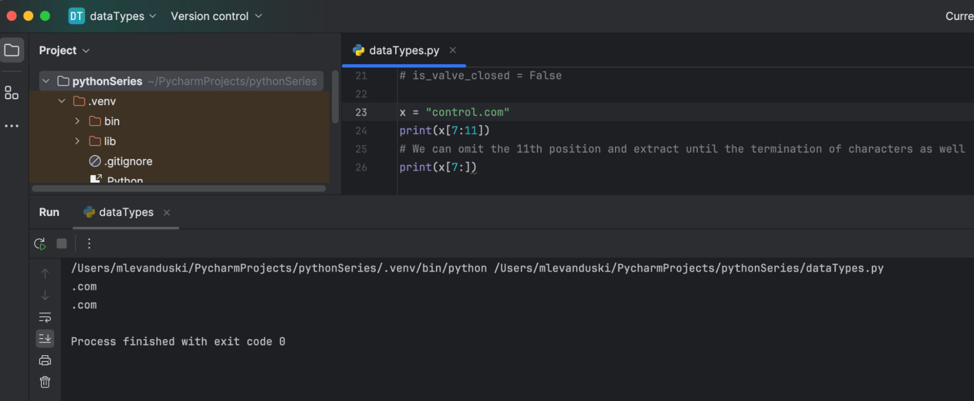

Lastly, it is also possible to extract a multi-character substring from the string. Let’s extract the “.com” from “control.com” using two methods that yield the same result:
More string slicing in Python
Figure 8. Substring extraction using string slicing. Image used courtesy of the author

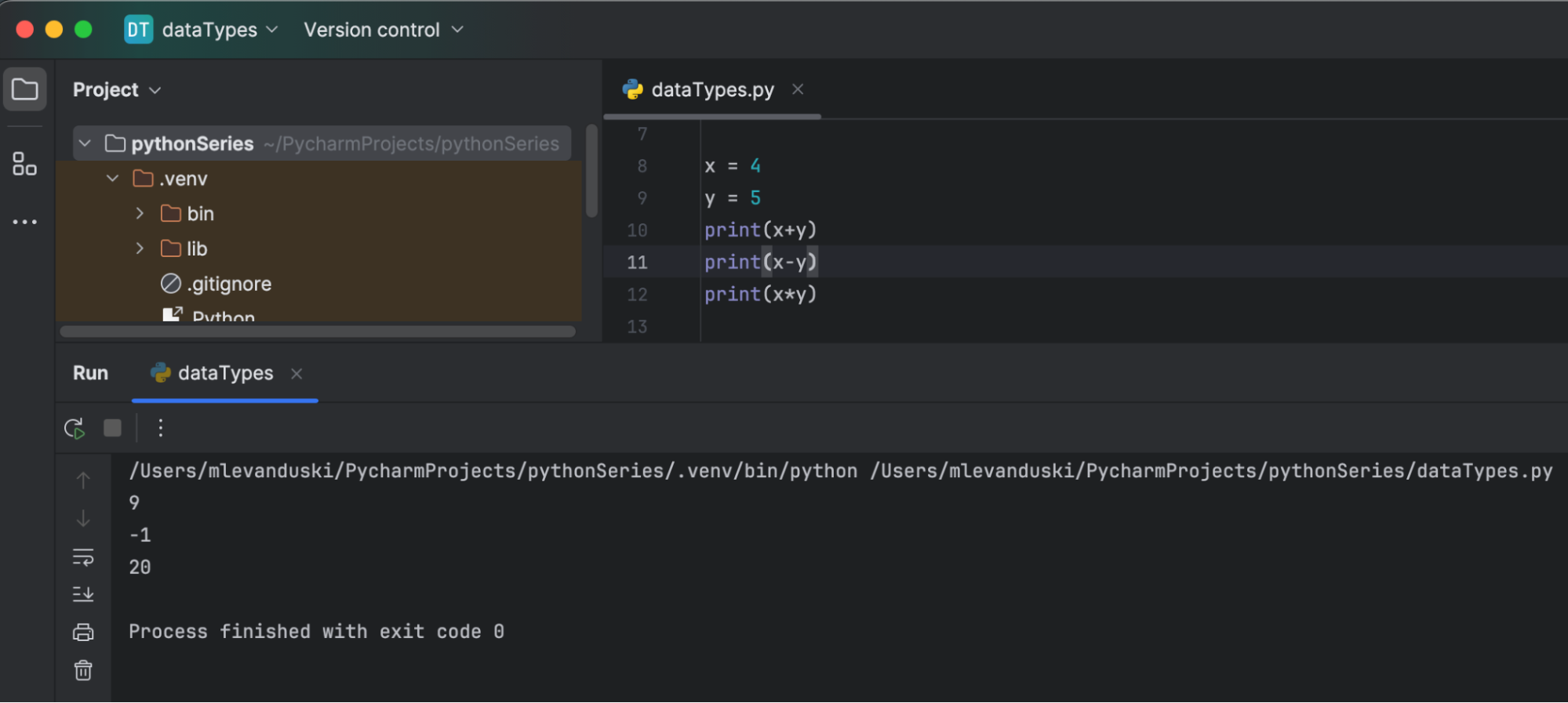

Integers in Python
Integers represent whole numbers with no fractional component. Like algebra, we can perform the typical math operations on numbers in Python: addition, subtraction, and multiplication:
Integer math operations in Python
Figure 9. The integer data type and some supported operations. Image used courtesy of the author

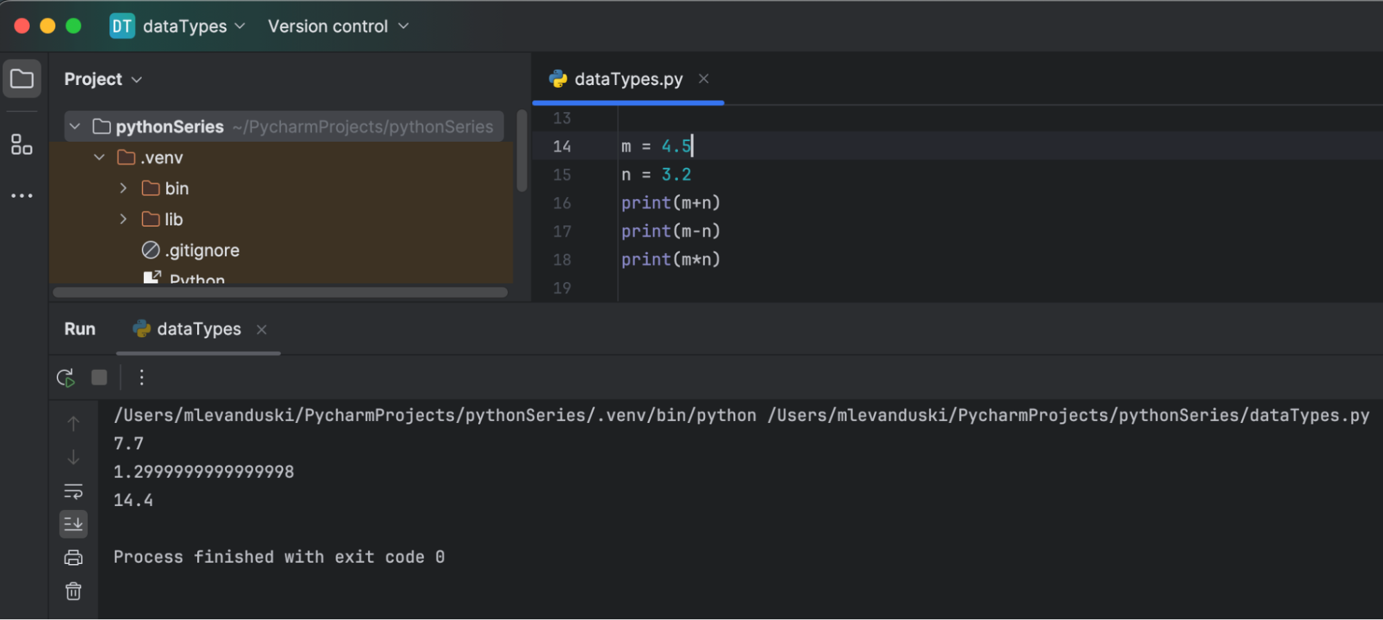

Floats in Python
Floats are the common counterpart to integers and represent fractional values. Similar operations to integers can be performed on floats:
Math with floats in Python
Figure 10. The float data type and some supported operations. Image used courtesy of the author
